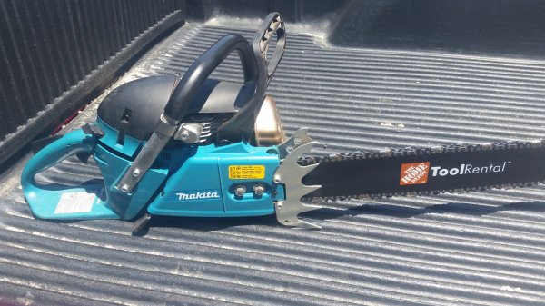

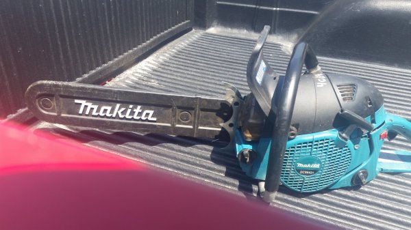

    Wasn't able to bring them down too much, but $300 out the door was more than fair. They had a little bit of an edge in the negotiations, as this was THE LAST ONE!! Luckily, for me, it is in great condition. There was a run on the others this morning, so I was lucky to get this one. We started it up, sounds great. Compression on the pull rope felt good. I don't have a compression tester, so I did what I could. I also had them remove the muffler and I looked at the piston. No signs of wear, or misuse. These were just the two pics I snapped outside the store. More to come when I get home. Probably a video, as well, since I will have to field test it immediately! :rootintootin:

    Saw looks great! Nice score. Hit up fordf150 he should be able to hook you up with a matching inner bucking spike.

    I was wondering why they didn't match, but I have never had bucking spikes before.

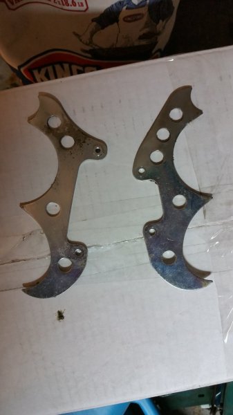

    Took me a bit to find them. Pm me your Addy and they are all yours. Someone might as well use em. Unless of course you'd rather rock the new style ones. In which case rock on with your bad self. I will warn you the new ones are almost too aggressive/large for my 7910. Not sure how they would be on a 6421.

    i cant tell from the pic but looks like that outer spike is the newest version. there are 3 versions of those spikes, the first 2 are NLA so you need to take Barcroft up on his offer or buy the inner to match your outer and that may end up meaning buying a full set if that outer one is the 2nd gen
