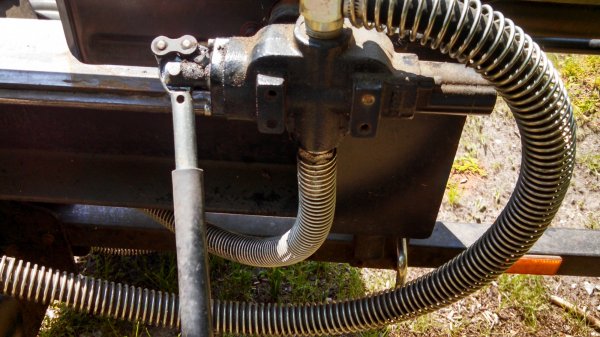

    As I was just starting to split up a bunch of Ash....
    This splitter came with the house we bought in Sept. of '06, and I have no idea how long the PO owned it.
    Anyway, is this a replaceable part, or do I need the whole shebang? (No, not a whole new splitter:rolleyes:)

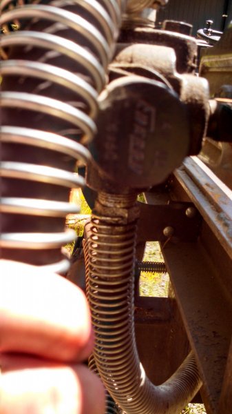

    This is on the opposite end......it says Energy.

    Hard tell from the pics... is it part of the valve?

    Looks like the linkage from the valve to the handle.
    You really yank on that thing egh? lol!

  4. papadave
    Nah, no Magilla Gorilla here. :)

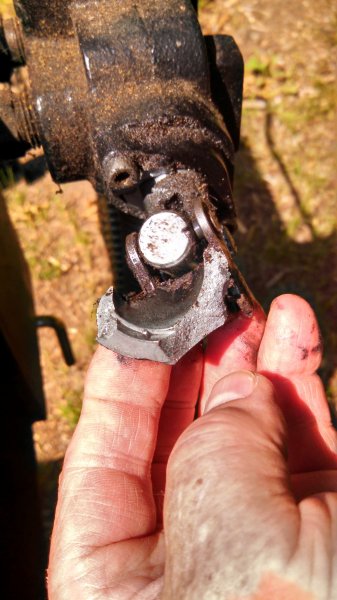

    I had just split a round and pushed the lever to retract, and it popped.
    Fatigue is my guess. It's a cast part. It's the little cover piece held on with a couple allen screws.

  5. HDRock
    17,250
    60,371
    Looks like a piece broke off of the end cap of the valve, is that what it is?

  8. papadave
    Yep. The lever attaches to it.
    I may have found a replacement part, but there also may be different versions depending on the model. Valve Lever Bracket - 718-0523

    See if this helps: Energy Hydraulic IPL :) part # 6 626264B bracket with screws
    http://www.energymfg.com/pdf/17498X.pdf
    Log Splitter Valve and Accessories by Energy® Manufacturing Company, Inc. $16.97
    Ebay has the MDT for $16.99 free ship- energy may just be the hydraulics used on many log splitter brands.
  14. papadave
    Thanks ChipsFlyin , that's the exact part I found, and it seems to match the broken bracket.
    Is there any major pressure there to be concerned about? Doesn't seem so.
