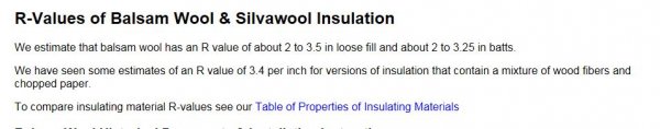

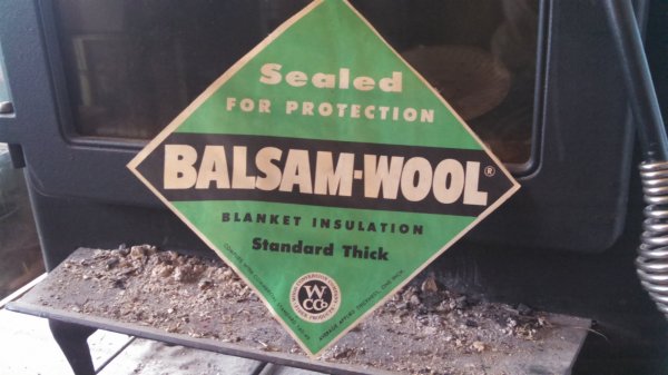

    Balsam wool” is a shredded wood product, treated with borax as a fire-retardant.
    Maybe treated with a mildewcide too.

    papadave ...welcome to the world of wood insulation! :)
    If it looks different it might be manufactured at a different time. I read that they started with just by products of milling operationa than changed to include different sources of wood.
    You'll love the improvement in R value...and the knowledge that you can now come over and help me! :)

    More insulation going into the attic as I can get it and have the energy for crawling around up there, but it's helping. I'd guess that stuff was the thing to use back in the day, but it's woefully inadequate now, compared to what we have available.
    I found it interesting...and noticed in both rooms I've gone through so far, that the old JM fiberglass insulation had shrunk from 3.5" thick down to about 2".
    That was weird.
    It's also why I ended up replacing all of it.:thumbs:
