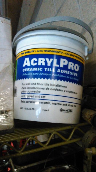

  20. BigPapi
    BigPapi
    Aug 19, 2016
    1,870
    12,765
    The hills of Western MA
    This is what I used if it helps.
