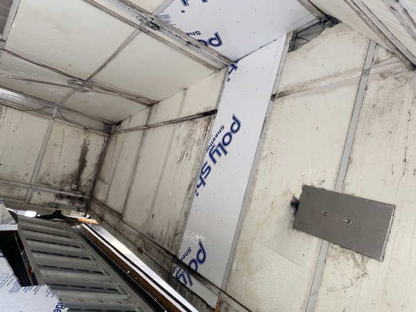

    37938ADC-16EA-4A08-8CEB-F8691720E39C.jpeg Inside of the trailer with our two 1996’s that I’m going to sell. Inside of the trailer has been insulated. That actually makes quite a difference. The trailer was in our driveway in VT for a few months in direct sunlight. The inside got warm, it never really hot.
    075F50A2-78C0-4662-939F-B748D7E5EBEC.jpeg I need to investigate some leaks and replace those insulation panels. The trailer has three interior incandescent lights that can be switched on with a switch near the front hatch. They do a pretty good job lighting up the inside. I was going to get some LED light strips to supplement, but the current setup works rather well considering.

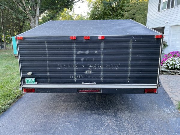

    8D139C70-31BE-465C-876F-57201FCB7B30.jpeg The two upper rear clearance lights had some water enter them. This one unfortunately has a bit of a flicker. I’m thinking of drilling a small weep hole on the underside to prevent this from happening. I’m not sure how these typically drain. Does the water usually drain behind the unit? If so, wondering of the top trailer lip and glob of silicone on these two lights prevented that.

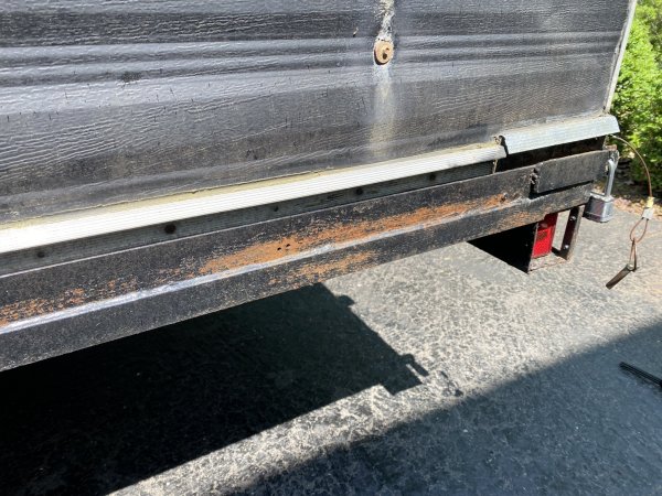

    I picked up a needle scaler from Harbor Freight and started working on the frame.
    Brushed on some primer:
    Removed a mouse house from the rear section:
    Found this with the scaler. Luckily, the only weak spot on the trailer. I did a lot of priming and painting underneath. I scaled, primed and painted the entire axle.
    The prior pain was a gloss black which I believe was just painted over without any prep. I went with satin which looks better IMHO.

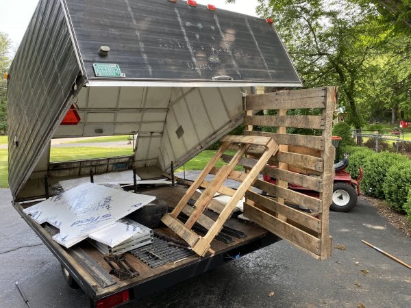

    I call this setup “The Decapatator” I had removed the shell lift pistons to gain access to that area of the frame. Installing them is a challenge. I’m going to need a second set of hands to install them while I hold the shell up. And that thing is pretty heavy!
    I’ve made some good progress on the inside replacing some of the foam panels that were damaged, moldy or crusty. I also found two more leaks and Flexsealed those from the inside and outside.

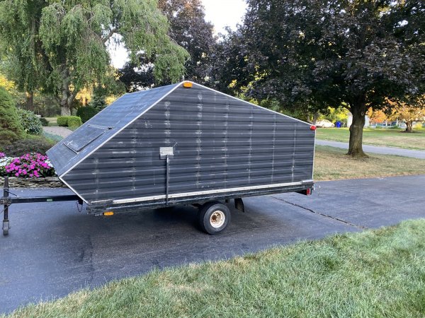

    And after having the Ridgeline since October, finally a test tow! IMG_7521.jpeg
    So a little funny story here…. The RL towed no problem at all. But the trailer was making quite a racket any time there was a small road imperfection. Granted, the trailer was unloaded, bit it’s not exactly “light”. I had a 1 7/8” ball for the 2” hitch. Not correct, but shouldn’t be making that much noise. I also had an anti rattle plate installed on the hitch/drawbar.
    Once I got back home, I realized the issue. Unloaded, the area where the pin is for the tilt feature moves about 1/4”+. So that gives a nice metal to metal “CLUNK” from time to time. I’ll fix that with some rubber.
