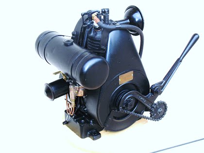

    not trying to sound sarcastic in any way, but OHV engines have been around longer than flat heads, almost all early engines were OHV style engines, when flat heads became the norm and the EPA started to put there clamps on small engine emissions, OHV engines came back to be able to comply, here's a pic of a 1921 briggs model F, i still own a few of the early briggs OHV engines........ GA2.jpg

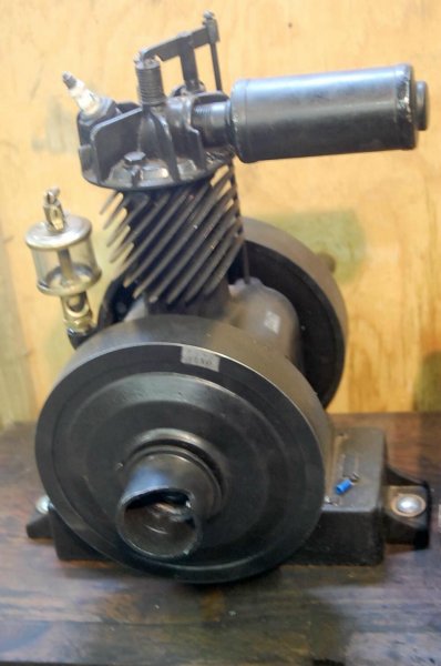

    yep, the only early briggs F sereies engine that didn't use a atmospheric intake, was the FI which had both an intake and exhaust valve controlled by push rod and rocker arm...... Briggs FI after resto.jpg

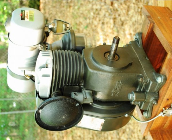

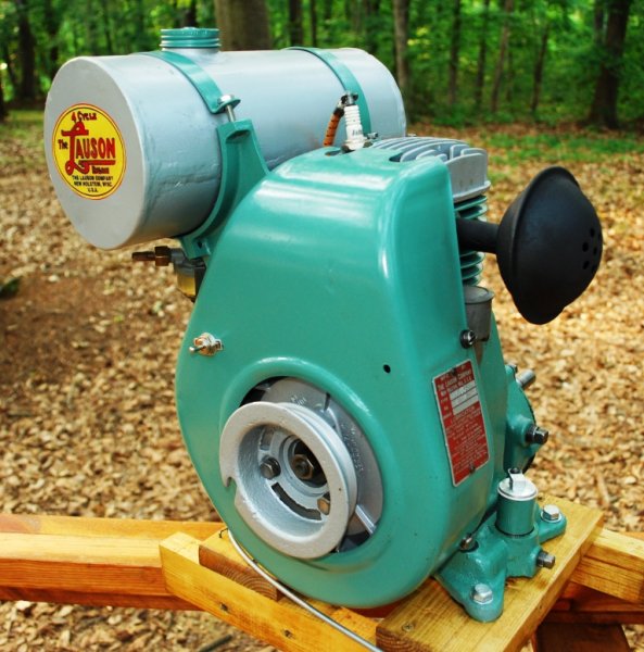

    6:1 was pretty much the norm for the L-head engines, any engine will dump raw fuel with either prime or choke or both, many of these tecumsehs/lausons had both a butterfly choke and a primer, i own an early lauson model TLH that was used on an early '50's snowblower, so they've been around for quite a while, also wanted to note, that there were a lot of the OH series tecumseh engines used on snowblowers as well, these had been in production long before the EPA/emissions came along, here's a pic of a lauson TLH, mine doesn't use the oil bath air cleaner, it is set up with a snow shield around the carb similar to what's seen on currant snowblower engines...... tlc.jpg
