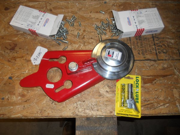

    I would think that just as with wire rope, the larger diameter sheave would be better for the line and any snatch block with the appropriate rating would do. I could see where the use of a snatch block may be less harmful to synthetic rope than to cable bending around a fairly small pulley while under load. This is just a guess, but I'd love to try some. The cost is always a consideration along with some abrasion situations I can get into winching logs in & through the woods. The light weight and good "spooling" manners sound real nice to me. HF has a pretty "normal" looking snatch block for $27. That's pretty cheap and the only diff. between it and a more expensive one I have is the acural sheave is aluminum (no biggie with syn. rope) and a hollow "axle", more like a 2" pipe vs a 1" solid steel on the expensive one.

    Liking the LocknLube in the photo - I've been using one for quite a few years now - the guy that got the distribution rights for it was a co-founder of the logging company my wife works for, so she got a pretty good deal on them.

    Screwloose , your portable winch reminded me of this winch. It is used to help heavy machines maneuver steep slopes. Please keep us updated on how you like your setup over time.

    Nice - I like both those winches. It is fun to study how things have been built to be compact yet functional.
    It looks like the drum on your newer winch is relatively small in comparison to snatch blocks I’ve used, so I think the snatch block won’t be a big issue. If you use a self-releasing style you might need to pay particular attention to the style of the edge it releases off, and make sure you don’t get a rough edge over time.
    I’ll post a picture of the one I use with cable later today.

    This one came to me second or third hand. I would think a thicker, rolled edge would be easier on your rope if you were to be using a self-releasing one.
