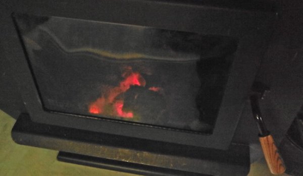

    40° now
    24 hour + burns
    In the low smolder mode again
    Using the splits that don't stack as tight , no fan 1.9 on stat
    Will reload around 10,---- 7/8 loose load.
    thin coating of black 3/4 the way up the glass

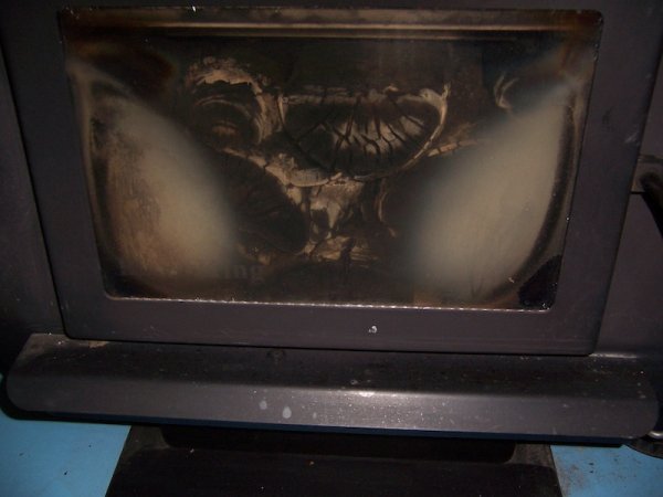

    At first I thought it was high moisture content in the wood.
    But burning 3 years seasoned , dry birch, still get black glass, just the nature of the beast .
    Sometimes the heat dragon eyeball look:

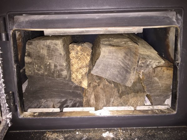

    BogyDave that is also what we got the first few times we put a fire in our new stove. We have yet to put a full load in like you have in the pic. For now (because it is mild and we are well insulated) we have been putting 4 splits in -3n/s and 1e/w on top of the 3 and it holds about 5-6 hours and the family room where the stove is hits about 80-85. The glass stays pretty good. Since after we clean with damp towel and ashes we then use stove top cream before the next time. This way it comes clean a lot easier when I do get at it. Our wood is 3 yr min so its not likely gassing off enough to be a big factor. Guess every stove and each of us are all a bit different. These days the house stays good until next afternoon. Our BR is cool anyway so we just close the door and then have our coffee and reflection time in a warm room.

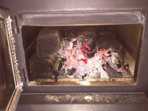

    Honestly when you finally buy a princess you will be blown away. After 7 hours a load in a BK is just getting started.
    Here is a load after about 8 hours. This load went about 26 hours, the sst was about 200 when I reloaded.
    Chvymn99 and papadave like this.
  15. papadave
    Jeesh, that much wood left?
    What kind of stove temps when running like that?
    That's just phenomenal.

    Mine would be 350ish,maybe more maybe less.

    Think it was a little over 400* after 8 hours. It will usually run in the 300-400 range for a long time. That wasn't a full load of really good wood, 2 bigger oak splits and a small one, the rest was silver maple and cherry.
