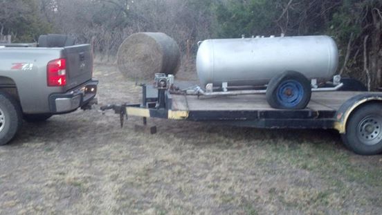

    I got the opportunity to snag a barely started smoker/ grill project for a couple hundred bucks. Its based on a 200 gallon propane tank. Any input you guys have on the build would be appreciated. I'll get more pics posted after I pick it up Friday.

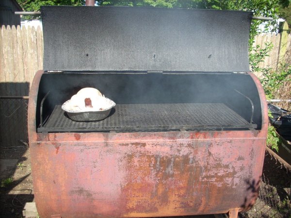

  5. WeldrDave
    9,422
    49,463

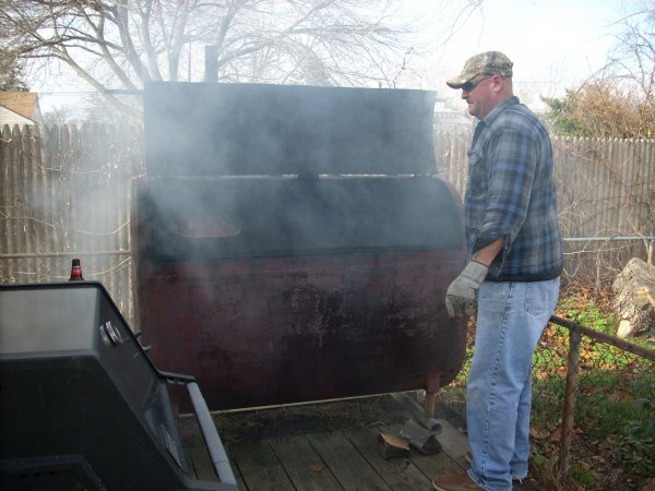

    I'll post a pic of mine and it'll give you some Ideas! There are no rules in smoking except for one, after 225* your really cooking. That tank is "SWEET" and will serve you many years.:cool:

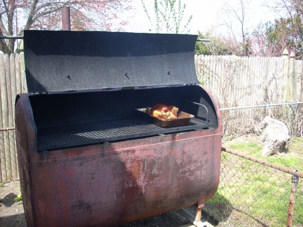

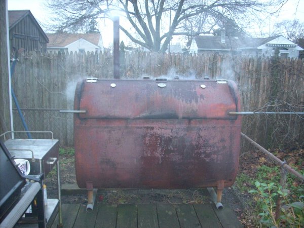

  9. WeldrDave
    9,422
    49,463
    Ryan, It's a very basic design, The grate is removable /seperate and slides out. There are 4 angle iron cross pieces that it sits on welded across from front to back, and down at the bottom is the same thing, angle welded acrossed and expanded metal layed across the angle. There is a clean out door at one end so you can hose it out. Drill or burn about 2 holes on each end about 1" in diameter for air, don't go much bigger or it'll burn up your wood to fast and then your cooking. This is # 5 cooker, I use mine so much that they don't last but maybe 5 years or so. This is an old oil tank, your propane tank is thicker and you'll get many more years from it. Oh, also, "DO NOT" make your vent/exhaust to big, you'll go through way to much wood and you want to keep the smoke in!
    Enjoy, have fun.

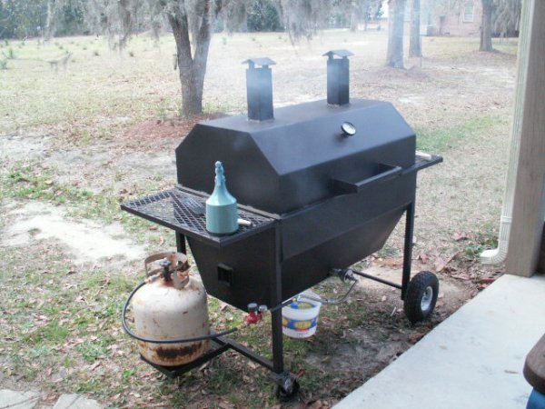

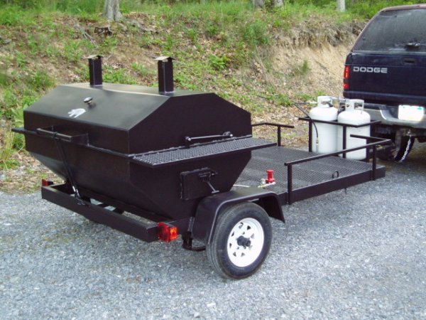

  10. TurboDiesel
    16,154
    96,776

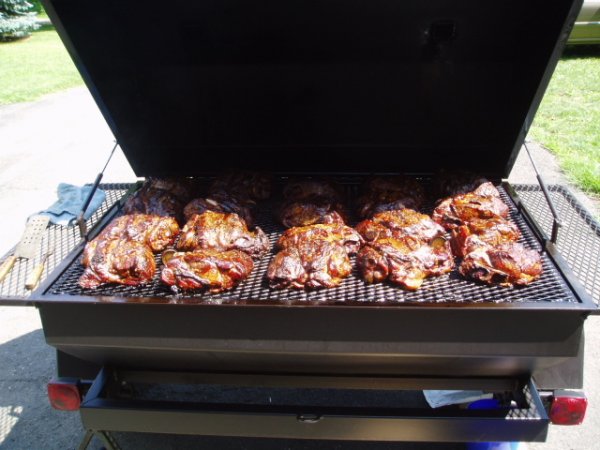

    here are some pics of mine

  11. WeldrDave
    9,422
    49,463
    Your Pig roaster is very nice! My cooker can do about a 125lb pig at best, For me thats fine for friends and family. The slide out grate is exactly what it was designed for and also to reload the charcoal. My cooker is going on 6 years old and this may be the last year for it, she has some rust in the bottom and I expect her to fall through this year.
    No Worries! got another ready to go! ;)
  12. Chvymn99
    20,324
    106,229
    TurboDiesel those smokers are sweet! Gonna have to do a more indepth thread on them. :grizz:
    WeldrDave Love them pictures of your smoker, always have some fine food coming off them grates.:cheers:
  13. WeldrDave
    9,422
    49,463
    Thanks Chvy, shes almost done for...:( I'm hoping to get this summer out of her. She don't owe me anything. I keep the grate and send the barrel to the great scrap yard in the sky:tears:

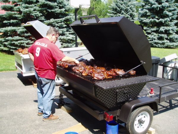

  14. TurboDiesel
    16,154
    96,776
    Chvymn99 and WeldrDave like this.

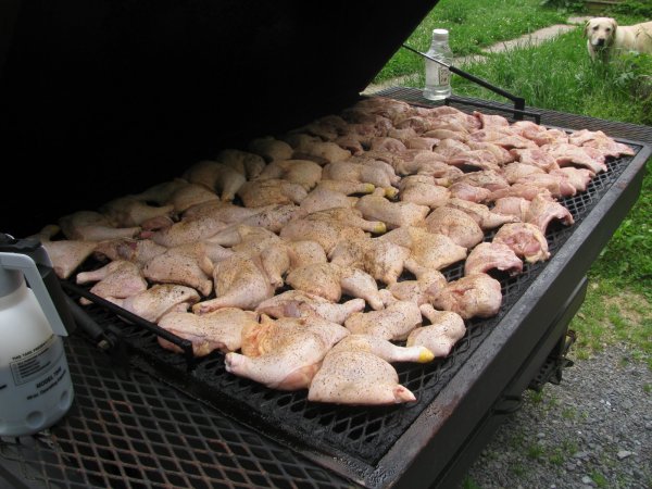

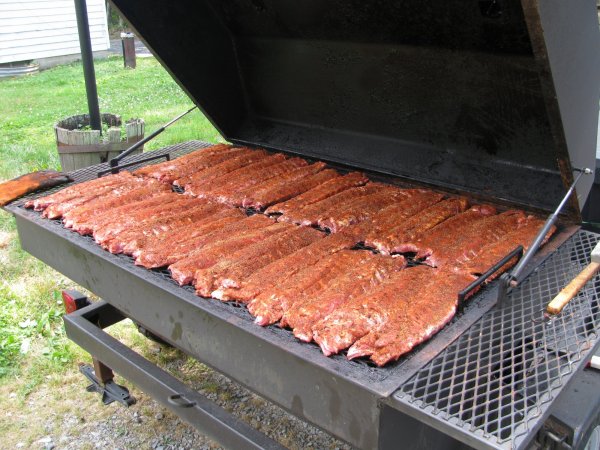

  15. TurboDiesel
    16,154
    96,776
    Thanks WD.
    here is a pic with about 160 lbs of pork butts .
    Was helping a friend with a benefit dinner to raise money for a local school park/playground
    Our friend in the second pic is checking out the pork to see if its good.
    His cooker is in the background with another 130 pounds on it.
    Wayne is the guy who got us started into the bbq cooking. Sadly he left us 2 years ago in march.
    But the Q must go on

  18. Chvymn99
    20,324
    106,229
    Wow weeee.... That the Cats Meow. Firebox? Cylinders for the lids? :thumbs:

    Got the project picked up Friday night. Its going to be a pretty big project.
