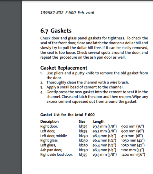

    Maybe needs a new door gasket. They do wear out with regular use. I was shown the dollar bill test. Take a dollar, close the door and latch. If you can easily remove the bill it needs a new seal.

    It would probably a good idea to start with replacing the seals on both doors and see if that cures your problem

    This stove actually has 4 doors. The 2 in front, side door to the right and the ash pan door... I may do all 4 at the same time...

    Could be the hinge pins/pivots worn too...but likely just an old hard compressed gasket...make sure when buying gasket that you get not only the right size, but the correct density too...if that stove uses a high density gasket, and you go to the store and pick up what they have in stock, it will very likely be low or maybe medium density, and not seal right.
    Sometimes if the gasket is not too hard, you can take your fingers and pinch it to make it pucker up and get a little better seal for a while...maybe get by until spring.
