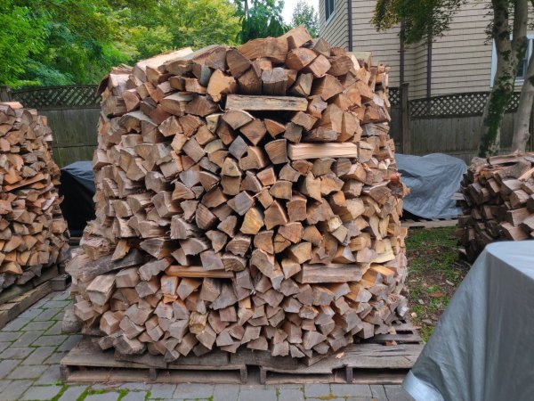

  6. rainking63
    rainking63
    Mar 4, 2020
    319
    3,101
    Old Lyme, CT
    Hey, thanks for the shout out! Dimension-wise it's 10' diameter at the base, so there's four pallets and one cut in half in the middle. When it was fresh it was stacked to about 8' at the peak, but I assume it has since shrunken a bit as some moisture escapes. It holds just under 3 cords. It fell once because I didn't do the "rings" on the side. My avatar is the before. Here is the after:
