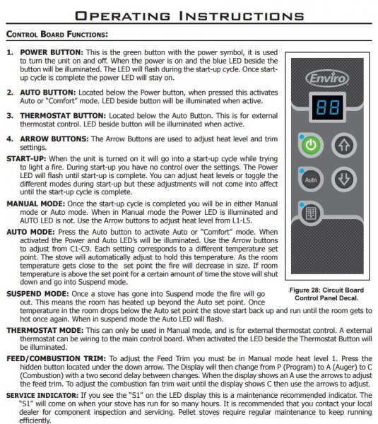

  17. jtakeman
    12,230
    55,143
    Yes the mini's do have the hi/lo, auto/off, and a manual setting. P3 has a new controller that maintains room temp in Auto/off similar to a harman IIRC. And a manual mode to use a external stat. I think it is the hi/lo mode. Stove will ramp up to a set heat level setting until stat is meet, Then idle to its maintain setting. But not 100% sure as I have yet to tinler with one.
    Looks like the Castle has a similar setting to hi/lo mode too. It also has a built in 24hr stat. And a remote control.
    Seems to be what the newer stoves are leaning to, Set a temp on the digital stove controller and it tries to maintain it??
