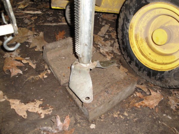

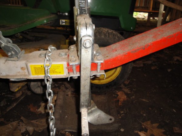

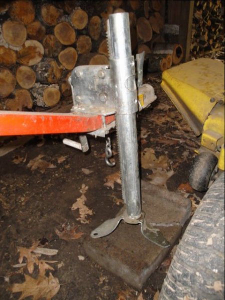

    DSC00124.JPG DSC00122.JPG I don't have much level ground to set up my splitter so I put on a wheeled tongue jack and took off the wheel and pounded the 'wings' as flat as i could. I use a level to set up my splitter. Sometimes the tongue is only a few inches off the ground and other times I have to put it on a block to get it high enough.

    That's the solution I've been thinking about. Tractor Supply has a tongue jack with a skid rather than a wheel. Combined with a couple of R.V tire wedges that should take care of matters.

    I don't have any welding skills so I had to use a bolt on tongue jack. I needed one that would allow me to lower the tongue practically to the ground.
