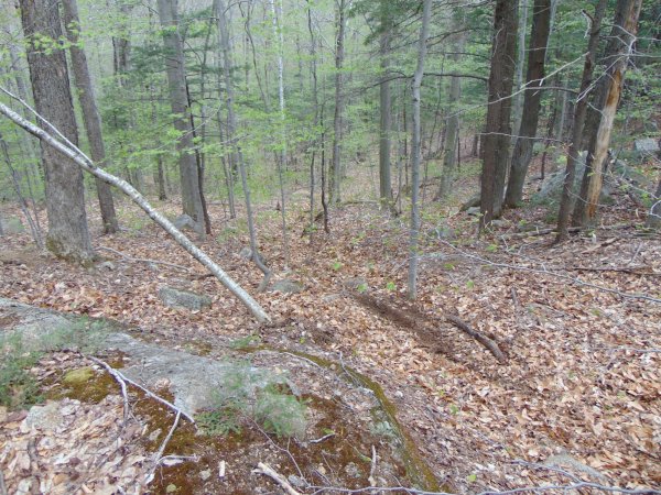

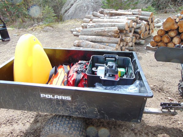

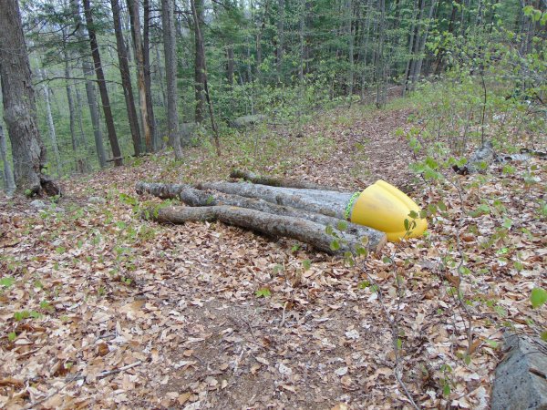

    They're another tool in the tool box. They can be a lot of gear to carry if you're scrounging and I usually don't have a clear line of sight so it requires multiple rigging set ups and pulls. Still, they do give you access to otherwise unobtainable sources of firewood. The one pic shows the larger PCW5000 with bags for rope and chains, as well as the skidder cone, so you can see it can be a lot to haul around. I also have the smaller PCW3000 set up on a backpack which is more maneuverable (and also works great for big game). The other pics are just an example. Pulled the beech up from about 100' downslope (much steeper than it looks in the pic). Would not have bothered trying to get the tree without the winch.

    That cone is sweet! Seen the sleds for skidding before but the cone seems pretty failproof!

    It's been a big help, virtually indestructible, and definitely cuts down on the nose end of the log digging into the ground. It is one more thing to haul around but it's worth it.

    I’ve seldom used the cone but I’ve got some work coming up where it might see some use.
