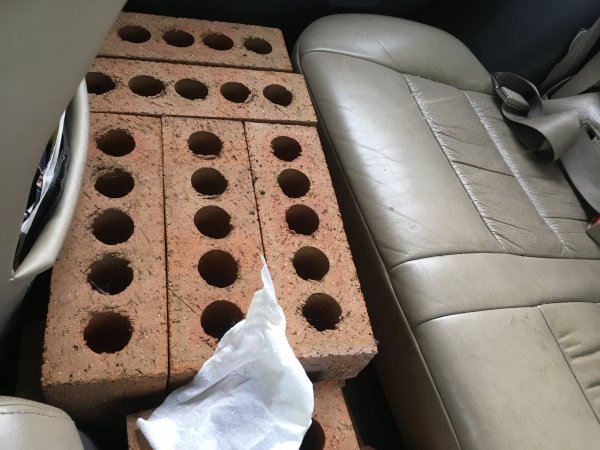

    Oh ok I thought you meant for the inside of the stove. I think I would like to try to cook too of course. Not spitballing here just thinking of a half cook station half convection deck. The options here are pretty open but not sure if I have a lot of sources of soapstone here that have a cheap minimum of work. So i'll start with the firebrick as you say and later figure out what to do later. The cool part is that if my wall is built and have some left over they will work. I dont think i put a picture of the brick up yet so...well here's some of it. I got something like 125 pieces. Some are rectangular and some have an angled end and can be used oppositely. Ones with angled end have 4 holes just to give you an idea. Like 10 inches at the longest, those are 11. IMG_1622.JPG
