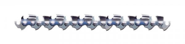

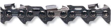

    There's semi-chisel and full chisel. Semi is shaped like a question mark (left most cutter in pic) and full is like a number 7. Semi is best for dirty conditions and is more durable. Full chisel cuts faster but can be more prone to dull if you hit dirt or other non wood debris.
    Then there's full comp, semi-skip and full skip:
    Chain Sequence Explained
    If he was telling you to get full skip, for a short bar... don't listen. That's designed for cutting very large wood with long bars (36" and up).
    If you buy Stihl chain, get the yellow stuff, not green. Some chain is designed for the unexperienced homeowner to reduce the chance of kick back in case you try to cut with the wrong spot on the tip. Looks like this:

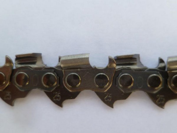

    Chisel with no anti kickback
    Stihl chain with the yellow link
