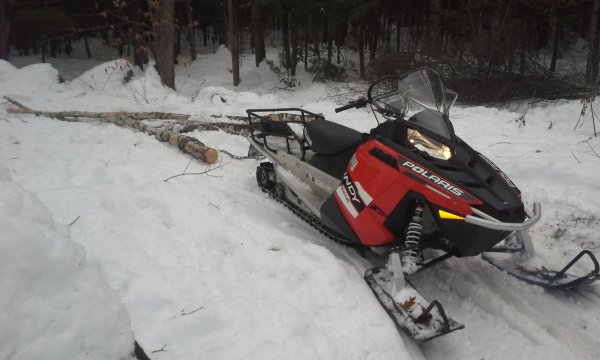

    As for the snowmobile, it's a 2015 Polaris Indy 550 Voyageur, which is designed as a utility sled (why I bought it). It's got enough grunt to skid logs and is already set up to tow, so the sled isn't the issue (other than it's somewhat of a PITA once you get into the timber due to being 11.5 feet long).
    Pic is from several years ago when I was skidding out some smaller birch trees (PITA without the skidding cone!).

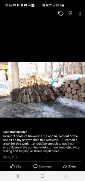

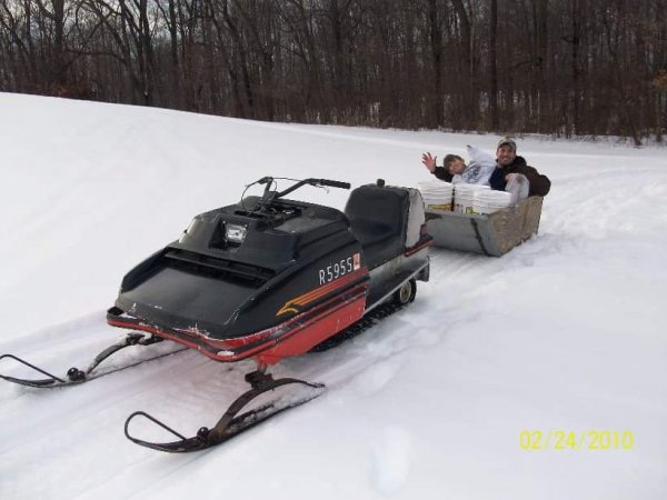

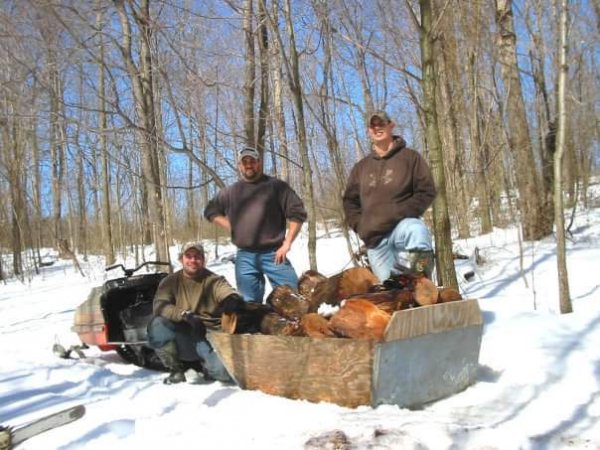

    I've never "skidded" logs with a snowmobile before but I've hauled HUNDREDS of firewood loads off the neighbors farm over the years with my old Chaparral SSX 340 and the homemade firewood sled I built for it. If the snow is wet and sticky, it can be a PITA, but powder with a broken-in trail it was a breeze and I actually really enjoy doing it. Hauled tons and tons of old, standing dead, barkless/sapwoodless gypsy moth kill white oak off of that farm for many years, it got me through heating the house several winters early on in my firewood career.
    I still use it for hauling a little bit of wood off the farm (and when we do maple syrup, if there's snow around), last few years have been really lean on the snow though. I've gotta dig the sled out and get it tuned up soon....

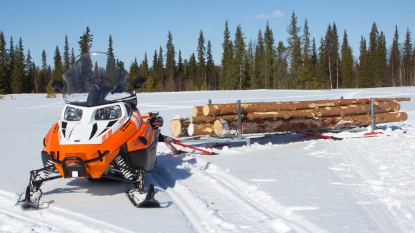

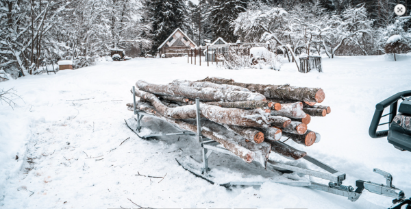

    Hauling rounds out isn't an issue as I've done plenty of that with the snowmobile and have swivel Y tow arms for both sleds. As noted in the OP, it's the issue of getting the timber down off the slope to where it can then be processed and hauled out. Because of the slope where the timber is, it's just not practical (or safe) to tow a trailer or sled behind an ATV or snowmobile, which is why I am looking at skidding the logs down.
    I've looked at a lot of different setups and depending on how things go if/when I finally try to skid some logs down, I may end up making something along those lines. I would love to have a timber sled from Iron Baltic or Ultratech (as shown below), however those are not available in my neck of the woods so something homemade would have to suffice. I don't have to skid the logs very far, just off the slope (although if I had one of those timber sleds, I would just use that to bring the logs back to the house).

    Was that homemade sled completely flat-bottomed or did you have runners on it? Love those old homemade wooden sleds, so much more durable than the commercial garbage sold today.

    Those timber sleds are pretty cool. It would be a fun project, pretty straight forward couple sets of old snowmobile skis and some square stock. I think I would make the removable uprights work as a ramp to roll a log up with a cant hook. Of course that many not work well when snow covered.

    It was a tin bottom with angle iron runners, it does ok but if I ever built another one, it'd be raised runners. Lot less friction that way.

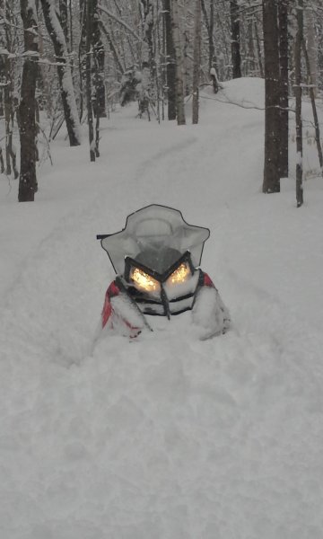

    I've run snowmobiles enough over the years so no issues breaking new trails and no issues hauling (pic below is at the bottom of a decent slope after blazing several miles of new trail in a foot of fresh powder). I have extra wide floatation skis and a 155 track for off trail riding. Skidding logs downhill is the new wrinkle. I like your idea of getting a trail packed first and if I decide to skid with the snowmobile, I'll probably make a few passes up and down, perhaps while cutting up the trees, and then wait a day or two before I try to skid the logs down. Hauling the timber out once at the bottom of the slope is not an issue. As for how steep the slope is, I'll have to reassess that when I go back out there. One spot on the same property I scouted out last year for dead and down had a slope where when I was coming back down after breaking a trail going uphill, I could see that the snowmobile skis hadn't even touched the ground for 3/4 of the way up the hill. Fun times.
