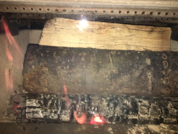

    These splits aren’t huge but there’s about 4 of them, 2 more behind the new ones in. This is the most I have filled my stove to date. As you can see as it is best for east west with what Alder Im using now. I have lots of splits that are much smaller in length and can try a N-S tonight. To mention that this may likely be the best load to date as this fire may last for longer than I expect it to. Well I can keep track and let it be known which way also works best along with split sizes. Im intrigued now since temps are cold enough for this experiment. I do have a few of what I call “grandfather splits” of alder. They are just half rounds but at least 10 inches wide. Two will fill my stove well and I’m leaving those for the holiday break.
