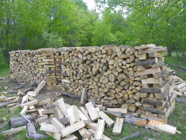

    For more years than some of the people on this forum have been around, I've stacked wood in multiple rows with excellent results. Usually I stack with 3 rows together. No problem at all getting that middle row dry.
    Case in point: Most of the time we stack 3 rows together which gives us a cord or a little over a cord per stack. We stack around 54" high and usually do the stacking in the spring. Most times by fall the stacks have shrunk down to 48" high due to the wood drying. Now it would seem to me that if the center row did not dry at the same rate as the 2 outside rows, then that row would not shrink as much. However, all the rows shrink at the same rate. This also says the row that is on the side that does not get as much sun or as much wind still can and will dry.
    To top this off even more, we have stacked wood in the shade and still had no problem with it drying. But one would have to be careful stacking in the shade. It has to be in a high and dry spot. I know of some folks who did this in a swamp and could not understand why the wood was not dry even after 3 years. I talked them into moving the stacks and then within a year all was well. So if you stack in the shade, it has to be in a dry spot. If the ground stays moist for a good part of the year, do not stack in the shade.
    I apologize to those who have seen most of these pictures before but they are the best for examples here.
    2013 wood-1.JPG Christmas-2008a.JPG Getting wood for winter.JPG May 2014-e.JPG Wood-2009f.JPG Wood-2012a.JPG Wood-2012c.JPG Woodpile-1 2014.JPG Woodpile-2 2014.JPG

    No need to apologize Backwoods Savage! I for one enjoy seeing those nice stacks you've got there :thumbs:
