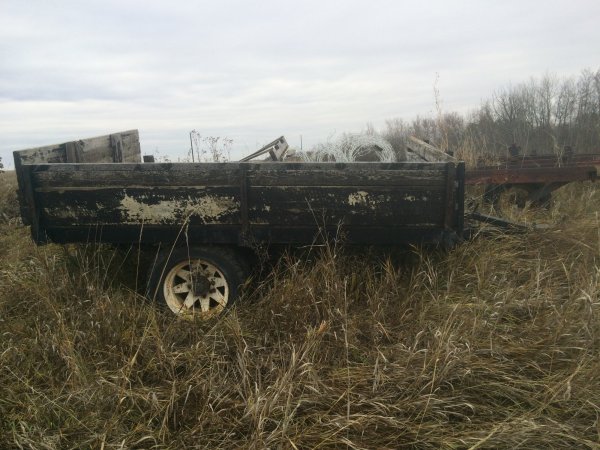

  18. saskwoodburner
    saskwoodburner
    Dec 15, 2015
    2,541
    14,282
    Prince Albert, Saskatchewan, Canada
    Sorry for the repeat photos, not sure what I did wrong with my phone camera. All better now.

  20. bogydave
    37,217
    Looks OK to me
    What's your road/license requirements for trailer ?
    Here it's "axle rating" - "trailer weight"
    axle 3500 lbs - empty trailer weight
    Example ( 3500 - 1000 ) = 2500 lbs max load.
    Gross weight 3500 lbs
    Home made :
    We get a trailer weight on a certified scale,
    take that to DMV get it registered with the specs on the registration .
    Get it rated the max you can.
    Dont' have to load to max
    but hard to weigh loads, may save a ticket ;)
