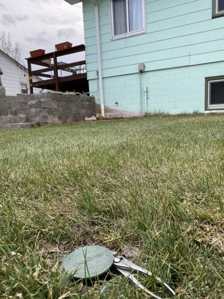

  6. Sandhillbilly
    Sandhillbilly
    Mar 8, 2019
    3,920
    27,464
    North central Nebraska
    There’s always the pop ups option D075A0CD-62AE-4370-8CC7-B6B21FB47E29.jpeg 206CC030-C9BA-4D0B-9DFF-BC5795A3158F.jpeg

  8. Sandhillbilly
    Sandhillbilly
    Mar 8, 2019
    3,920
    27,464
    I really like it, works pretty good. Can mow right over it & pull the whole thing off a couple times a year to clean leaves out
  9. fishingpol
    fishingpol
    6,502
    39,641
    Merrimack Valley, Ma.
    Does frozen water cause issues with it? I have some reading to do on these.
    metalcuttr and Chazsbetterhalf like this.
  10. 343amc
    343amc
    1,749
    5,765
    Northeast Lower Michigan
    I’ve got a few of those and they froze the first winter. What I did in the spring was take out the elbow, put some pea gravel underneath it, then drilled a small hole (about 1/4”) in the bottom of the elbow. Any water that sits in the pipe slowly drains out. I’ll remove the pop up a few times a year, take the leaves out and stick a screwdriver in the hole to make sure the drain hole is clean.
    Not sure if that is the right way to handle the problem, but it worked for me.

  13. Sandhillbilly
    Sandhillbilly
    Mar 8, 2019
    3,920
    27,464
    That’s how I handle it
