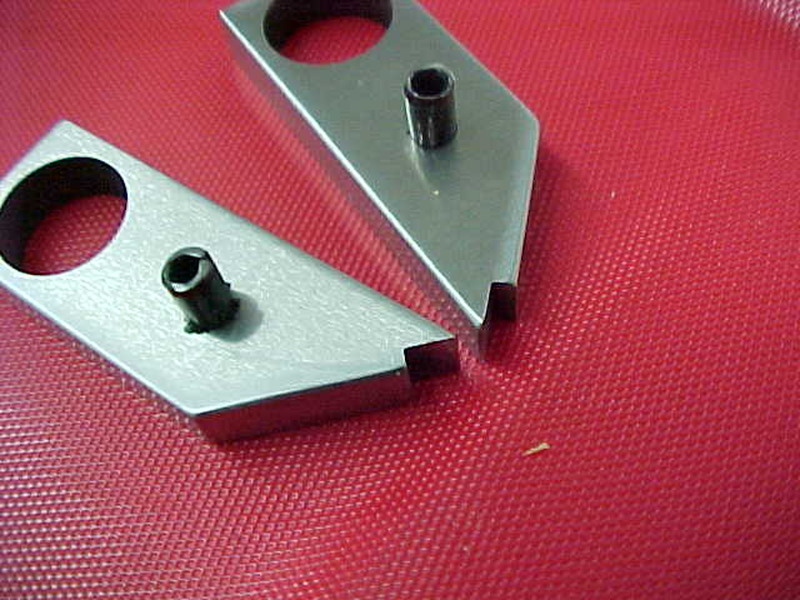

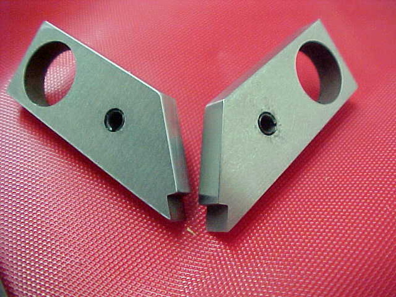

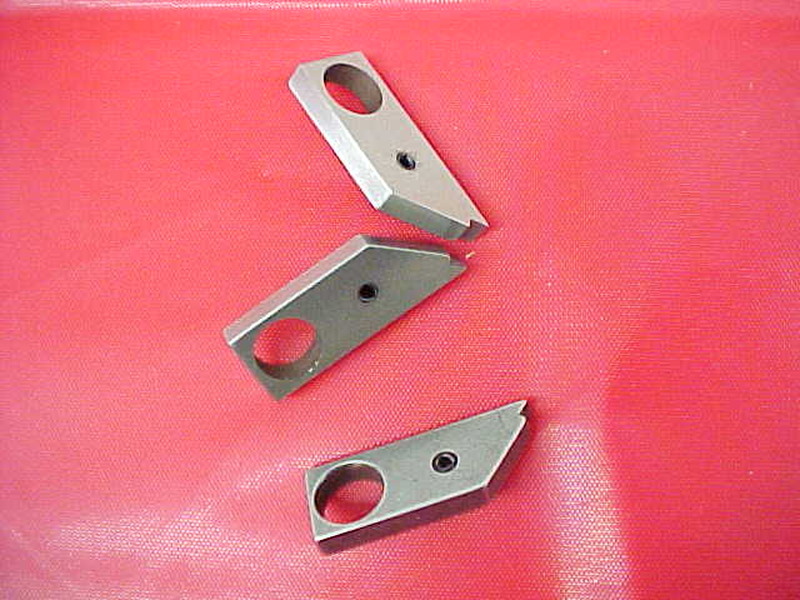

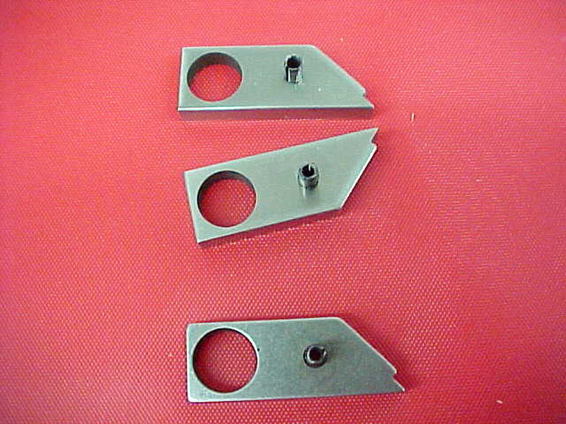

    Had a friend who was in need of some Pawls for his Silvey 510 chain grinder. His supplier dried up so he asked if I could make him some. While doing it and ran some extras so if any one needs them or wants some spares here is your chance. When they're gone, they're gone.
    I made them from A2 steel and are hardened to Rockwell 60 -62. As long as you don't grind into them. they'll last a LONG time, probably forever.
    .186 thick
    .498 wide
    .387 pivot hole(reamed)
    1.358 long(my overall length is not rounded off as much as they did.}
    hole to hole centerline is .550
    new .125 roll pin installed
    $25.00 each + $3.00 shipping
    PM me and they go in the order of messages received Prefer Postal money orders but can do Paypal if needed. Add 5% to cover the fees on that though. Thanks.
    New pair on top, original on bottom
