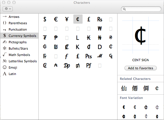

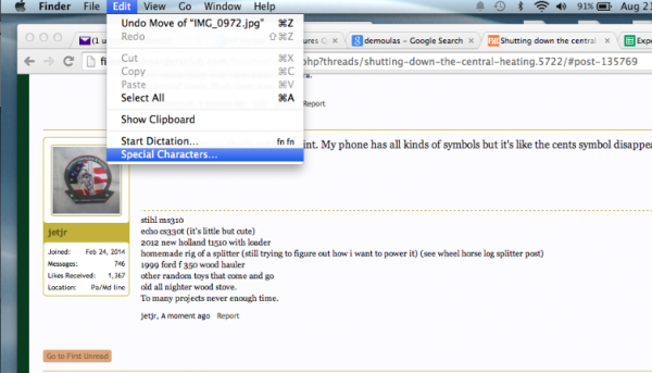

    @jetjr on a Mac (which I'm on right now), you can go to Finder and look for special characters under the Edit menu. Couple of screen shots to show you. In a windows based computer you can search for character map under the accessories menu and copy and paste from there. Good place to find the "°" symbol too when talking temperatures or "¥" for buying pellets in Japan.. hope that helps. Back to your regularly scheduled thread.....
