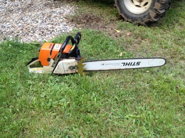

    So I bought this 460 last year from @MasterMech and really loved the saw. The saw was a project saw for him testing a big bore kit and a few other things. He even repaired a hole in the cylinder. When I bought it he said if I have a problem just let him know. So this year it started leaking bar oil into the cylinder and smoking like crazy. He took it home from the g2g and split the case and rebuilt it. Wow I love this saw, cuts like crazy and really digs into those big logs. Really want to say thanks to him. Great guy that stands behind his work. I would recommend anyone that is interested in anything he does and to buy from him. This is the kind of person that really makes this such a great place. Also thanks to @DexterDay for the big dogs! image.jpg

    Be careful with those dawgs. :rofl: :lol: I can't tell if there is a bottom spike hanging down? I had a set on my 460 and that bottom spike seemed to get hung up constantly. They worked good, but I have two holes torn in my chaps from them and one of my workers tore a hole in his leg (went through his chaps).
    Also I couldn't use the saw case anymore because the dawgs took up too much room.
    I was going to cut the bottom one off, but someone offered to trade so I did. I have a normal Stihl set like what comes on the 660 and 880. Larger than stock but seem to not try and kill me.

    Oh also the big dawgs tend to bend easy if side loaded.
    Mine got bent, maybe from one of my guys and I was stupid to try and bend them back. I ended up cracking the case.

    Thanks guys. I like those spikes on that saw. Just adds to the whole attitude of that machine, which started out as a box of spare parts from another build, a colossal mistake on my part (hence the hole in the crankcase that was repaired), a relatively inexpensive aftermarket rebuild kit, and a big "Hmmm".
    Saw ain't no beauty queen but it is a runner for sure. I also converted that oil pump to the HO or "R" pump. Should oil that 32" just fine for ya Swags!

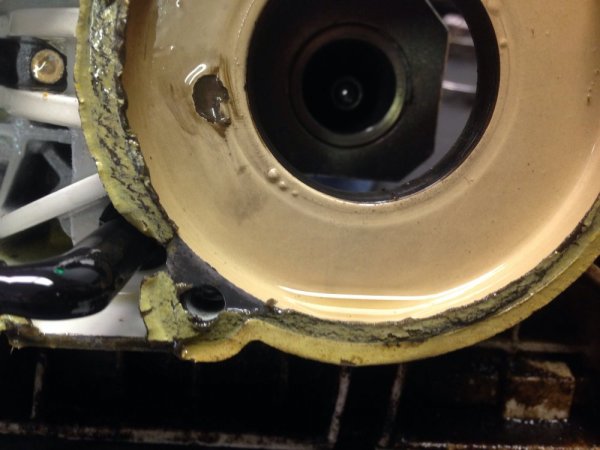

    MM, do you have any idea why the gasket failed?
  14. MasterMech
    9,648
    26,024
    Greenville County SC
    Inferior aftermarket part. Exposure to oil softened the gasket and it allowed the case halves to loosen up and start to leak. It was the only part in the "kit" that failed but Sean's saw now has OEM seals and gaskets.
  15. Jon1270
    Jon1270
    1,886
    4,543
    Pittsburgh, PA
    Wow. That doesn't even look like a gasket anymore.
