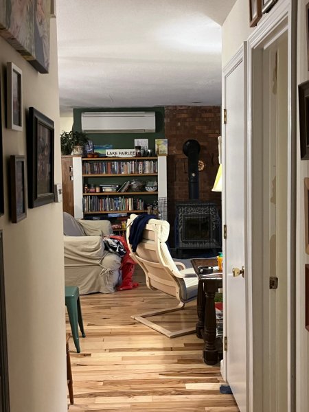

    Thanks for the responses everyone, kept a flame going on the fire last night and had good results! I needed to move around my top covers for the wood pile so with the top off I got a few weeks worth of uglies off the top of the pile.
    On the Mini Split topic. It really, really depends on the layout of your house. If you have a lot of closed off, boxy rooms like a colonial you are going to need a lot of heads and outdoor units. IMO, the most efficient way to utilize them is if you have a ranch with a long centralized hallway so it can blow down the hallway towards the rooms. The other benefit is one head tied to one outdoor unit is more efficient (because it can run on a very low BTU) than multiple heads tied to the same unit.
    I will turn mine on to take the chill off if the house is cold when we wake up but will be in the 60s or 50s during the day, especially in the spring when I am not burning with the same enthusiasm I was 6 months before. We also use it if we go away
    Price per BTU they are cheaper than electric baseboard, propane, oil below $2.50/gal, and cord wood above $300/cord. They are not cheaper than natural gas but as you know that is rare in New England. However, if you need boatload of heads/outdoor units it will probably never pay for itself.
    On the AC side, I use mine because it's there, but I didn't have it, I would probably just stick to good ole window ACs and not install one, the price of the mini splits are just not worth it for just AC currently in Northern New England. We added our mini split because our oil tanks and furnace needed to be replaced and we also have electric baseboard for extreme cold and to make the insurance company happy as some don't consider mini splits central heating.
    Attached is a photo of our setup

    Nice looking stove! and Home!

    One thing to consider is having them in an optimal area for heat is the opposite of what you want for AC. My setup is optimal for heat since the area closest to the mini split is warmest and further away is colder. When it's AC time you usually want the bedrooms to be colder. We are in a ranch so we usually run the AC until the outside temp gets into the 60s then shut it off an open all the windows. If it was a two floor house we would definitely need a second one for AC since the 2nd floor is usually way hotter. BUT I have heard of people in well insulated two floor homes getting away with one mini split for heat since it rises up the stairs.
