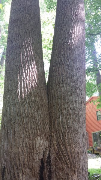

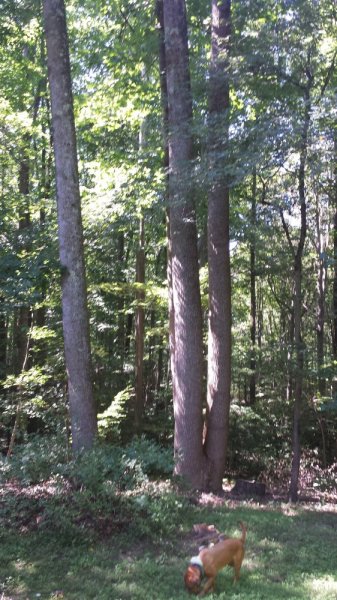

    Ok lots of post from me today ha! I have two sets of very very large tulip poplars off the corner of my house. One set is tri-trunked and the other is dual trunked. These trees are massive each at around 100ft tall or more.

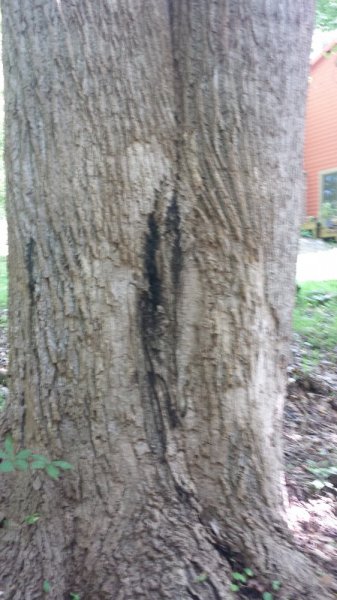

    There is some staining in the crotch of the dual trunked one and I am wondering if I should get an arborist out to make sure its not rotting in the base. If these do fall and come towards the house it would be massive damage to the house.

    Those are some big muti trees there ! If they are leaning toward a house... Outbuilding..or electric lines... Call a pro. The multi shoot trees always get crotch rot ! Bet theres bugs in there already :(. Nice trees though !

    If they are leaning the way you want 'em to go and no power lines are close, if you cut each trunk separately, above where the rot is, it's probably clean wood. Just watch the chip; If you see dark ones, you are hitting some rot. How good are you at cutting wedges and hinges. plunge cuts, etc? :saw:

    I would call a pro. There could be nothing going on...or a lot of things going on in there.

    Sometimes those can last for longer than you can. That one does not look bad but with the lean toward the house it is understandable why you will feel better getting it down. The wood is not the best for fires but not all bad. Really good for lumber. Find that pro and ask questions. My bet is you'll hear that it is showing rot and should come down. That is his business. I think you can make the decision without a pro's advise in this case. What you really want is a pro's advise or expertise in dropping that thing. Good luck.

    Tulip poplar is a pretty strong tree....I've cut several HUGE tulips over the years (the ones I did two summers ago were around 110'), the thing about trees like that is there is a MASSIVE amount of weight in them......I've broken wedges dropping them whole.
    My advice as a tree removal guy is to get an arborist in there to assess them for you. And if they need to come down, see what he'd charge just to piece them down for you....explain to him you will do the rest. I cut people breaks all the time if they want to deal with the clean-up and/or wood.

    If someone got hurt by the tree falling, and you thought the tree was a high risk, you would have a lot of quilt to deal with. I would get a pro with a good reputation to come look at your situation. Then have done what you need to do to keep the family and home safe. I have never missed a tree I had taken down. I am still surrounded by them but none that can fall on the buildings. Oh yes, nice looking fur friend you have there.
