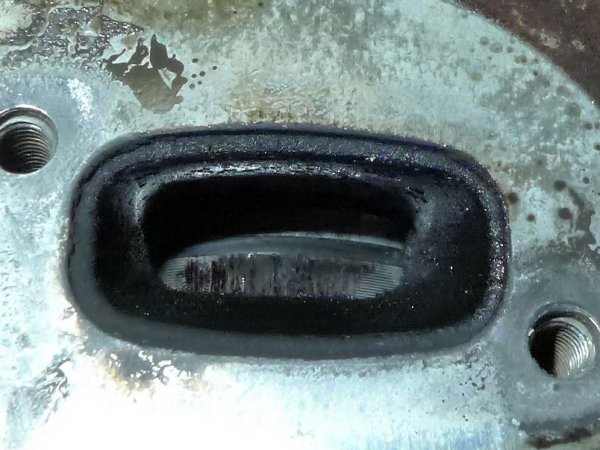

    Took a few tries to get a good pic, but here it is. It's a little worse than I remembered. The scoring is all up near the top of the piston; the lower area visible at TDC is pretty clean.

    That ain't that bad bro... I'd follow Dex's advice.. Clean any transfer off the jug and replace the piston and ring.. Make sure it's not an EPA dished piston. When you put her back together, be mindful of any possible issues like air leaks that could have led to the lean condition in the first place.. 350's are real runners when done right..

    I like that plan. I've never attempted cylinder cleanup before. Wasn't there a video going around here recently of a non-chemical approach?
  13. Hedgerow
    Hedgerow
    1,495
    4,849
    SW Missouri
    A little tidbit of info...
    I have done a cylinder swap between saws in "the field" that had some transfer on the "good" cylinder...
    Saw still runnin today.. So just clean it up best you can, and make sure she's runnin' a little fat the first tank or 2...
    Randy has done it non chem..
    I've only used acid, or nothing at all..
