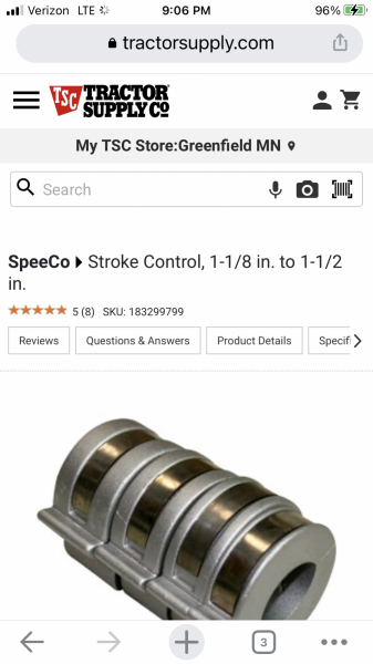

    I thought they made a donut or so for limiting the return and in my search looky what I found lol
    Splitter return stop block or other Ideas ?
    I like the switch idea, myself I stop the auto return when it is half way since I mostly split 16"

    If you are thinking about something placed as a spacer between the cylinder and the wedge/pusher you have to be sure that the attachment to the rod can withstand the stress of being pulled. Most are only engineered for compression.

    Cylinder is really designed to push and not pull.
    I have seen where someone put a sleeve on the rod to limit travel on return stroke and it ripped the end of the rod and the nut off inside the cylinder.
    Not saying it won't work but some homework might be a good idea.

    You can shorten the stroke so it only runs 18” if you only split 16” material. That 18” of rod you’re not cycling.
    rugged made splitter’s actually have two holes drilled into the beam for installing a block specifically for that purpose.
    you can also use stroke blocks. This is common in farming for adjusting digger depth on farm implements. So it’s not a new technique. This is the same idea behind a block on the beam.
    you will likely need to reset the return detention pressure so it’s not smacking so hard on the wedge. Rugged made made a design change to have a larger wedge bolt to attach the wedge to the rod for this reason.
    You can install a larger pump as suggested. Install a larger fluid return line to the tank etc. change out your fittings and such to the largest sizes in the valves/cylinder. Get rid of 90* fittings and go to either radiused or 22 1/2 or 45 degree fittings.

    I don't know what to tell ya then, unless it was a crappy setup. They are the best way to limit stroke length because they are easily adjusted, reliable, and can be removed quickly. I might put one on mine for when I am working by myself.
