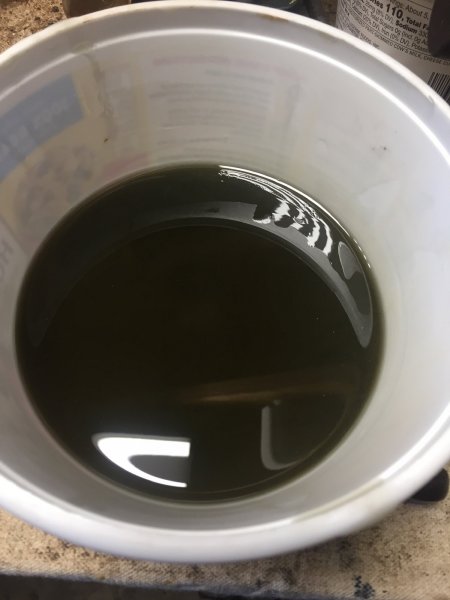

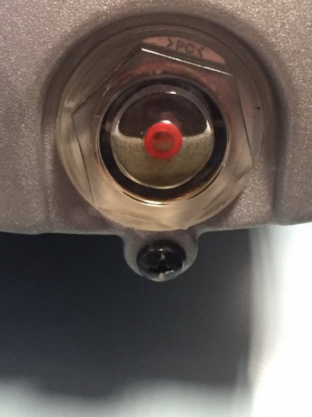

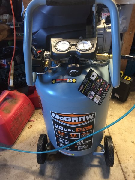

    For the time being, I’m not yet that serious about getting serious I guess.
    Ended up at HF.
    This guys was 2 beans and there was $25 coupon.
    Ran 1/2 hours unloaded with the tank drain open, per the instruction, for a break in.
    And then changed the oil.
    E2DCC8F7-ACDF-4774-B284-658DF41D8681.jpeg 50E13AC2-09E7-4398-85A3-2A3BFCD638AF.jpeg
  16. JustWood
    JustWood Guest
    Now keep your eyes peeled for a crapped out compressor with a big tank. Plum the tank up inline and you’ll have air storage/recovery capacity. Then you’ll be able to run air tools better
