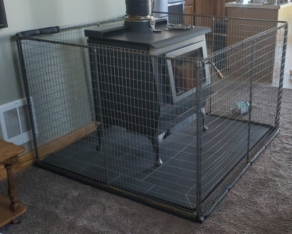

    I didn't risk it, previous home had a custom wood enclosure with door. Here, only 2 woodstoves for heat, both of them got plastic panels around them. Since then we used them camping to contain the two dogs and more recently for blocking chickens lol.
    Only issue we had, but smelled it quickly, was when she tossing her security blanket in the air and it landed on a stove. Looked like a burn from a clothes iron forgot on shirt lol.
    brenndatomu and MikeInMa like this.

  7. MikeInMa
    14,593
    104,204
    We have a tri-fold screen the gets setup when kids or animals are visiting. It folds up and is stored behind the woodstovevwhen not needed.
    Even with space a consideration, why protect just the glass? Protect the entire stove, imo.
