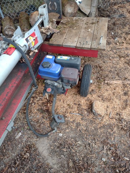

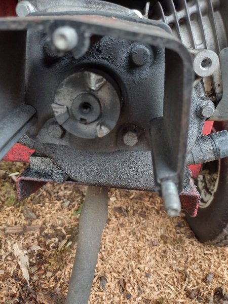

    I had 7 rounds to go. Was trying to finish before I returned the splitter to my buddy. It was weird it wasn't even really loading it up when it finally sheared. Had pushed it pretty hard in some oak last week, but it was moving through the pecan pretty easy then pop and it stopped moving. I knew exactly what happened. At least it busted on me so I could fix it before I gave it back to him and it blew out on him after a half hour or less!
    I called him and said I won't be returning it tomorrow I will have to pick up some couplers and fix it. He said he had some in the shed that he would bring to work so I could fix it. I said I would buy one or pay him for it. I will just buy another one for extra to replace the one I use so that he can have one for his shelf . IMG_20220901_193402387.jpg IMG_20220901_193413587_HDR.jpg

    Well that stinks...but you didn't do that. I mean yeah, it finally failed while you had it, but those jaws have been running without a spider in between for a long time.

    It looks to me that the rubber spider might have given up long before it sheard itself. The metal fingers that sheared off are two different colors as if it was half worn through.
    Keep this in the back of your mind as something to check on occasion.
    Should be an easy fix.

    That was my question. Looking at parts I see a rubber spider insert also listed but I saw no sign before of one ever in there. I have peeked at it in the past but it's not visible.

    I noticed the older metal and the fresh shear.

    The rubber spider keeps the jaws from wearing out, like they did, because it was run so long without the spider.

    Back when I was doing hydraulic work servicing industrial trash compactors this was a common problem.
    Replacing a half worn spider on a preventative maintinance service was not out of the ordinary.
    Just keep an eye on it , and if it starts to go away just change it.
    The coupler halves will never wear out with the rubber in there

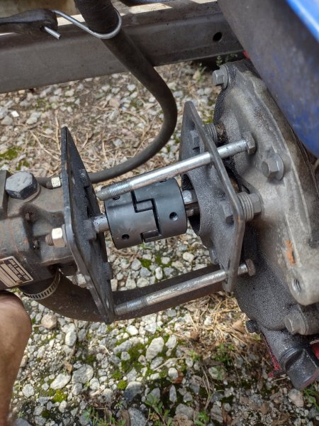

    Ok fixed it this morning... correctly.
    In this picture I am clearly just holding it there cause once I put it together the correct way a safety shield covers it and you can only see it from underneath. IMG_20220903_112321215_HDR.jpg

    Looks to me that someone has made some type of change.
    The nut and 4 washers between the plate and side of the engine does not look factory.
    Functional = yup
    Original = nope

    I'm betting that's a replacement engine.
