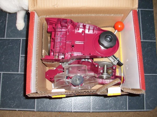

    Me ! , Upgrading from HF grinder , much more solid tool, Northern Industrial Tools Bench- or Wall-Mount Chain Grinder

    At least you got yours out of the box, further than I got :D.

    Well, I did put it together , just didn't mount it or plug it in, put a little WD40 in a couple of places to smooth things out .
    The grinding wheels came undamaged and rang true.
