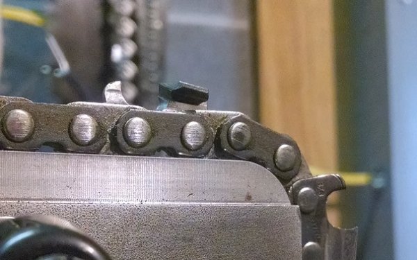

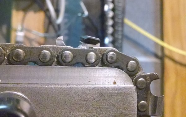

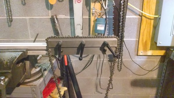

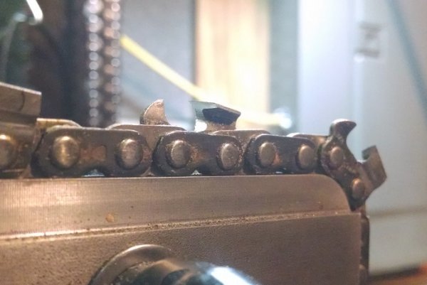

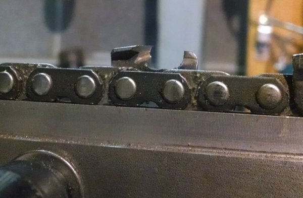

    I didn't know if there was any interest over here for chain sharpening. Here's some pictures of sharp cutters and the filing vise I got from homelite410 on AS.
    There's a square ground cutter
    square filed
    square filed again
    Filing vise
    round filed cutter

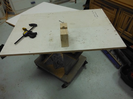

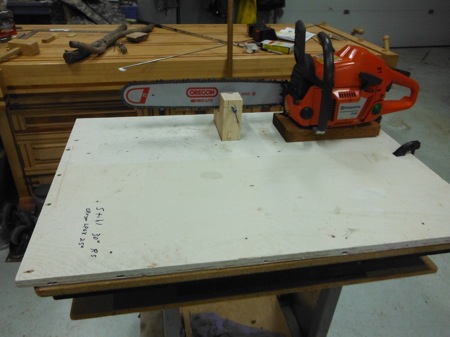

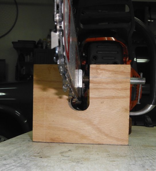

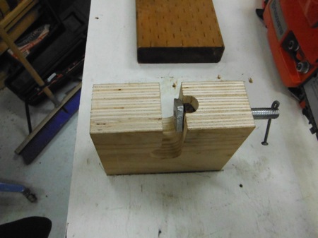

    Made a vice/ bench top for sharpening. Top clamps to workbench.
    I leave the same chain on till it's done
    (unless when out cutting it hit something.)
    After each cord +/-, I clean & file, ready for next trip .

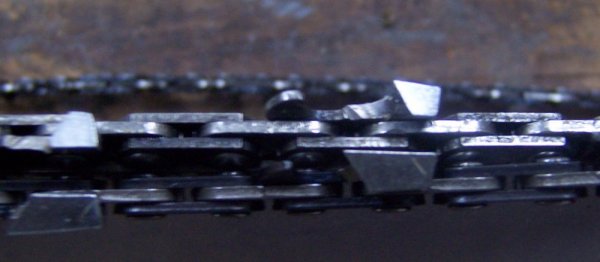

    Here's the silvey RS II.
    Hand filing square
