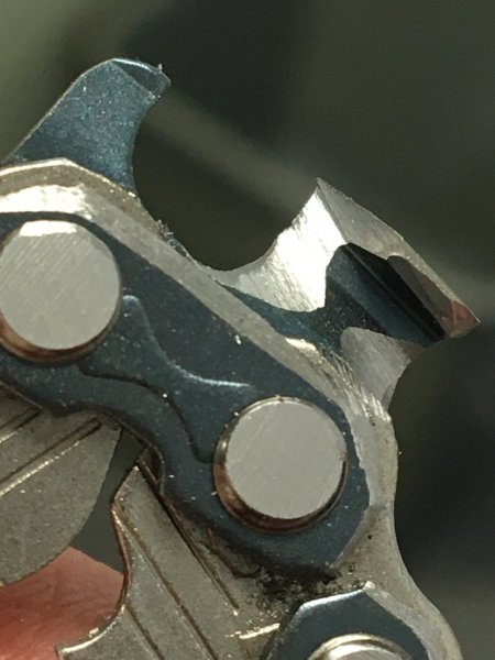

    One of these puppies will help ya keep the proper hook on each cutter. E14A1AE8-B8C5-425E-AD3A-613693C3213B.jpeg
    And the progressive style raker gauge will keep you cutting straight no matter how different the length of those cutters become.

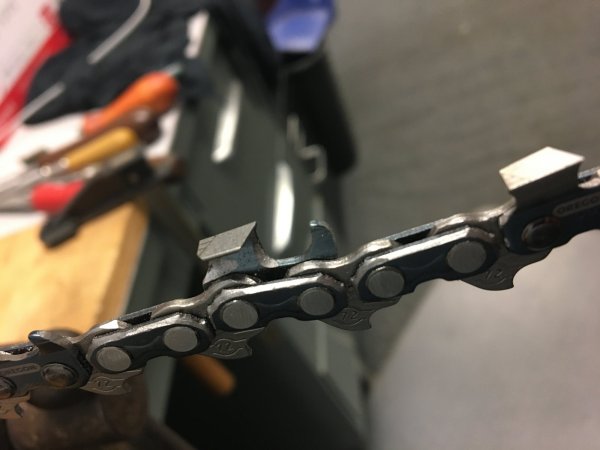

    As far as removing damage, why not just use the proper size file? Take light strokes till the file starts cutting smooth, then apply more pressure. My last oak score had me bumping the ground frequent producing this:
    PITA but the wood was worth the metal lost on a loop of chain. 135 drivers isn’t exactly fun either.
