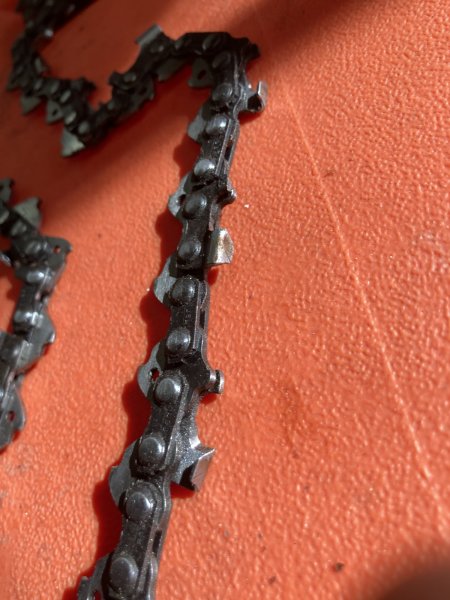

    I am inconsistent when I file a chain by hand or with a dremel. What do you guys use? I saw a hand jig that clamps on the bar and have seen electric ones.
    is this chain too far gone to keep sharpening?

    The drivers look really worn or hammered off from sprocket. Might just be the lighting. The teeth have lots of life left. I don’t like filing 2 rakers. I’m a hand filer and one raker is enough filing for me.

    The roller guide Husky sells works great to help you learn to do it freehand, or just use it all the time. Give the kit a try, it's not that expensive. LEss than $20 most places.
    Just make sure you get the right one. The 3/8 kit is a different color, but I believe you have .325
    And, still lots of life left in that chain.

    There is a lot of life left in that chain

    I think it is just the l
    I think it is just the light. The upper left you can see they are the normal depth.

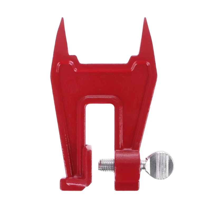

    Got one of these clamps in my Amazon cart right now.

    I looked them up. Are they worth the extra money?
  11. NBourque
    NBourque
    Jul 12, 2016
    261
    726
    Maine
    I have the pferd only cuz it was cheaper than the stihl 2 in 1 a few years ago. Pferd makes the stihl sharpener so the two are essentially the same product.
  12. Backwoods Savage
    46,953
    295,743
    Yes.
  13. PA Mountain Man
    PA Mountain Man
    Dec 17, 2020
    707
    4,287
    Lisburn, PA
    One of the best inventions since sliced bread.
    I spent 40 years sharpening chains like I was taught by the old timer loggers.
    Round file and flat file, no guide, no vice.
    The Pferd makes it easier to get consistent angle across the tooth.
    Takes less time also.
    There are knock of cheaper brands, but lots of negative reviews.

    and I would cut a whole bunch of wood with that chain pictured

    The teeth have plenty of "meat" left but looks like its very dull. I freehand file either on the bar, on the bar in a vise or off the bar and in the vise. Ive filed chains until almost no meat left and they cut fine. Just make sure you file the rakers (depth guages lower as you sharpen)
    Once a chain starts cutting poorly its best to stop and swap out chains rather than continue cutting, unless you like filing.
