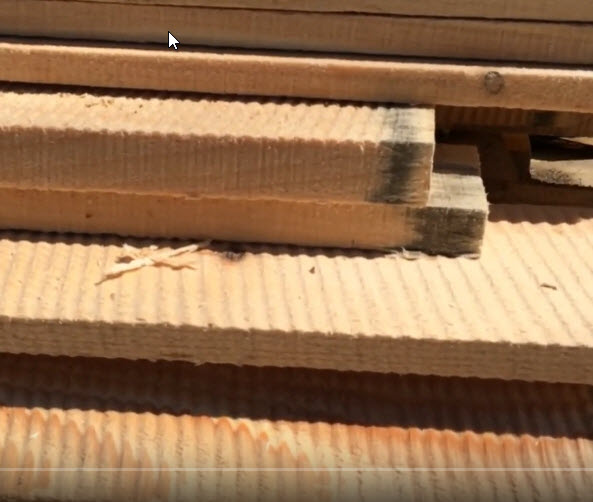

    Oh, hell, that's nothing. I not going to be making furniture out of this stuff. I was thinking just dimensional 2x4, 6s 8's etc and beams. This is a screenshot from a video of a guy running a PM14... Like I said, looks like a beaver went at it.
  7. PA Mountain Man
    PA Mountain Man
    Dec 17, 2020
    707
    4,276
    Lisburn, PA
    How the H E double hockey sticks did he make that cut?
