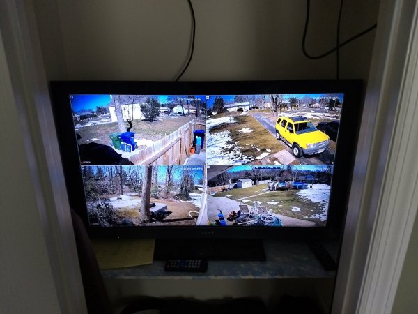

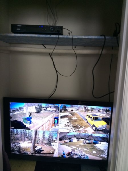

    I've got a 6 camera 4k lorex set up with dvr. The video quality is stellar. It runs 24/7. It saves about a week with the 2 tb drive but you can easily add more hard drives. I plan on adding 2. It's very easy to take screenshots or clips of video and put it right onto a USB stick for giving to police or uploading online.
    Each cable is 100 feet but can get a 300 foot one if needed. I have them under the eaves and 2 on the sides of the house. They run thru the attic and then into a closet in the spare room. You want to lock the dvr up.
    I'll take some pics later.

    I have this same system and its outstanding. Runs 24/7 and will not start overwriting until 2 full weeks. I can go back that far. Its not the 4k but its the 1080p and its 5 years old and I have not had to touch it in all those years. Most times, Ill rewind it to see what dog took a dump on my porch or which way the trampoline blew when it left, so Ive been lucky. Who knows, maybe they have saved me from a break in. The night vision lights up at night so they are visable. Check into Lorex, well worth it. Plus way cheaper now since the 4k ultras came out.
