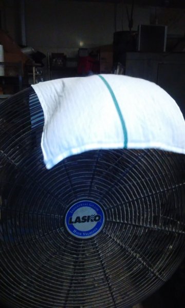

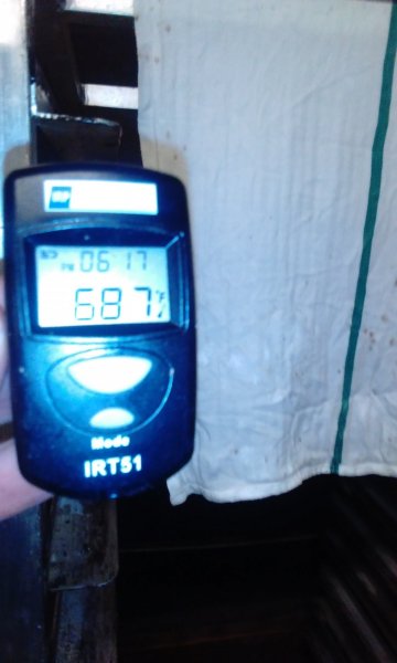

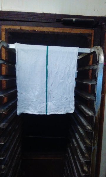

    Guess it does mean " Squat " The first picture is the room temperature in my prep area. The second is a wet cloth just hanging from a rack and the third is one of a wet cloth same size hanging in front of a fan on low. I started them at 6:13 p.m. and the one in front of the fan was dry at 6:34 the hanging one is still wet at 6:49 p.m. As long as the RH and the temp are the same it will increase drying time.

    Air movement is important- agreed......
    But air doesn't move across the interior cells of any given split, just the ends/exposed grain.
    A firewood kiln heats THE ENTIRE piece, causing internal moisture to migrate to the ends, where air can assist evaporation.... Yes? (At a certain temp that is)
    A wet/green/ high MC split in a fire does what? Pushes internal moisture out to the ends as the split heats up, where it bubbles and sizzles, robbing heat just to convert that moisture to steam.
    I'm a proponent of increasing the temp of the wood mass where the end goal is reaching a desired MC, quicker. That's only in the case that such a need actually is required.
