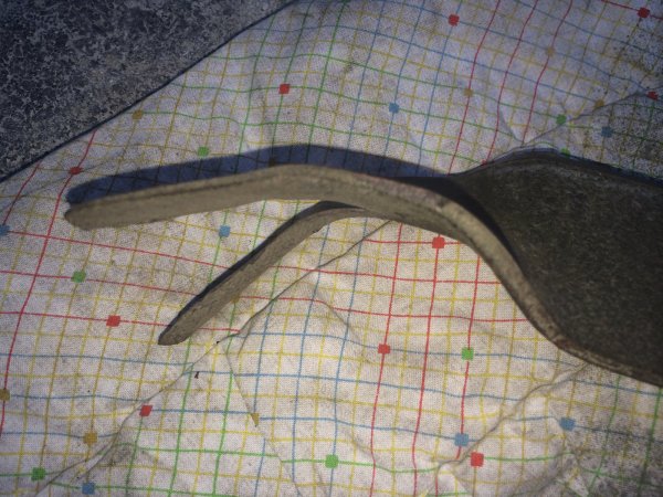

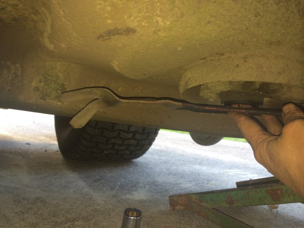

    Hello - Tractor really croaked! The pin that holds one side of the mower deck fell out and the right side mower Blade was making a horrible noise! Blade was scraping and hitting the mower deck housing! I replace the pin after attaching the left side mower deck and installed new 2 HD premium blades $41.98 after rewards and surprise bonus only $13.55 ! ! ! :)
    Just removed the bolt and changed the blade. I used car ramps to drive the front wheels of the tractor on and a soft blanket to make it easy!
    Click pic to enlarge:
    Pic 1 - Holy Crap this right side blade is bent!

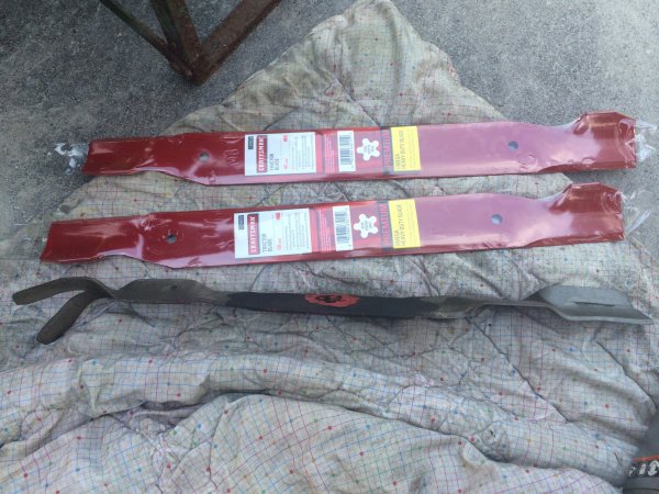

    Pic 2 - Old standard black blade vs new HD Premium red blades
    Pic 3 - Good end

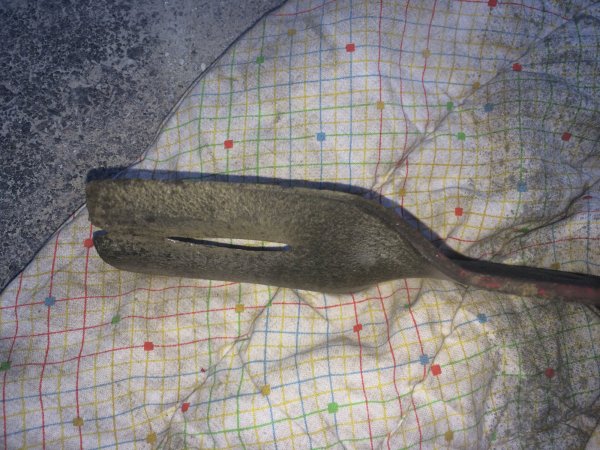

    Pic 4 - Bent end - Holy Crap!

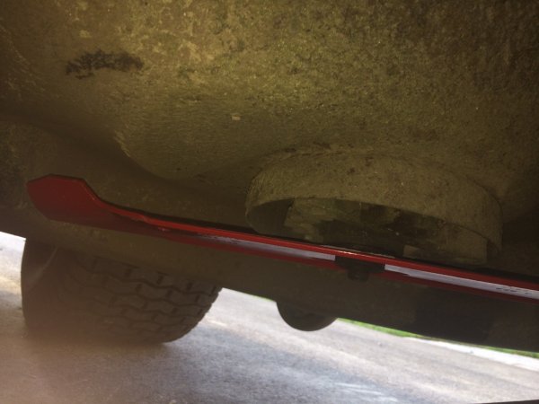

    Pic 5 - New Blade installed

    Looks like you wore through that set of blades. They usually will wear out at the heels like yours did or crack from the edge inwards.
    You done pretty good getting the tractor to outlast the original blades. ;) :p
