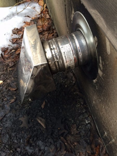

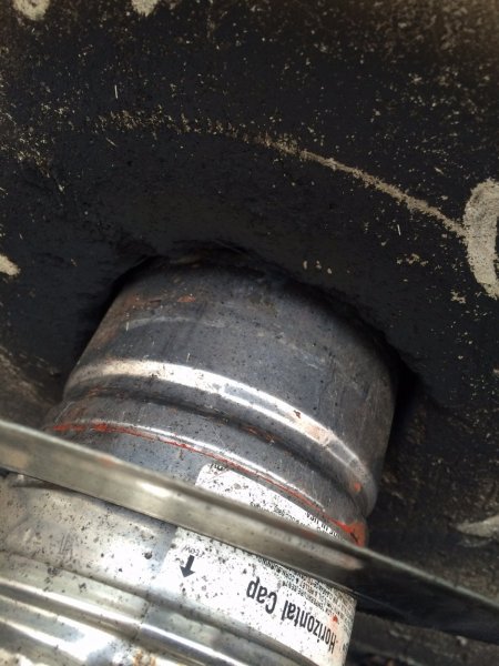

    What did you guys use to fill the gaps around the exhaust that exits the house on the outside?
    I went out to make sure exhaust was clear from snow and noticed black soot on the vinyl siding. Also see I didn't fill around the exhaust with anything on the outside.
    The inside I filled with high temp caulk but I remeber I ran out. That stuff had to be ordered.
    I don't think anything caulk related will dry in these cold temps unless the exhaust heats it.

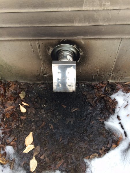

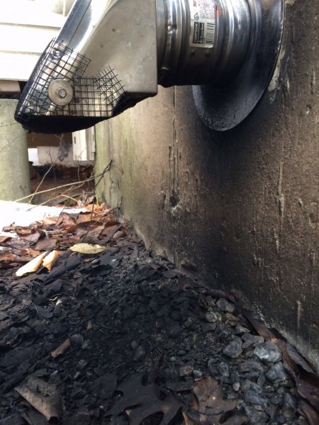

    Took it off just now! Thanks.... Here are some pics before I took off mesh. It was lightly covered, it was not much. I did follow specs in manual regarding distance off ground and away from house!
    Looks like I siliconed the end cap so it's not budging when I twist it. You can see in the last pic:doh:

    I was watching the exhaust, looks like it hits the floor and bounces back up:picard:

    Well it is almost legal.Yep exhaust hitting ground and bouncing back.I would not like that.At very least if you put a straight vortex cap on it would probably cure the soot on house problem 99%.If was mine I would prob go up and then away from house.And plenty of heat to dry any caulk,but you may have to scrub to make it stick.

    That termination is above the potential snow depth for your area?

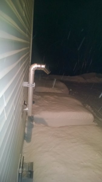

    Yes definitely go up.
    Russell and ivanhoe like this.
  13. T-BONE
    T-BONE
    Dec 7, 2014
    134
    449
    just like this

    I don't like the color of that ash.....way too dark. Sure looks like not enough comb. air.

    Agreed, looks too dark.
    It also does not look like it is at least a foot away from the house. Maybe just the angle of the picture though.

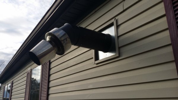

    You need to increase your burn air (open damper) That is a dirty burn, caused by to little air.
    As for the clearance? I would want to be higher than that. At the minimum, I would add a 1 ft horizontal piece and add a jet cap (shoots straight out).
    I added a 45° to angle mine down, but that's because it is over 6ft off the ground.

    If that termination was at my house it would be under 3 feet of snow right now.

    It was cleaned not too long ago, it could be the residue from cleaning. Too short and low in my book.
