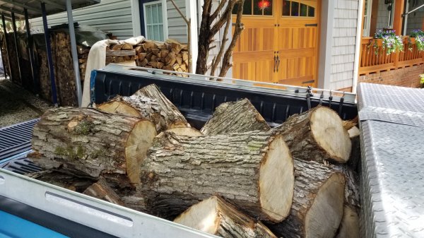

    Had a friend offer me an arrow straight white oak he took down. I left some of the top end but otherwise was a decent load. The 80% humidity and real feel temp of 96 made for a soaking. 20200608_133237.jpg

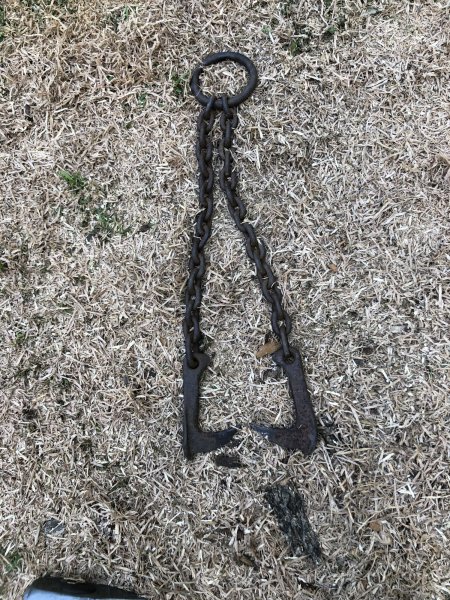

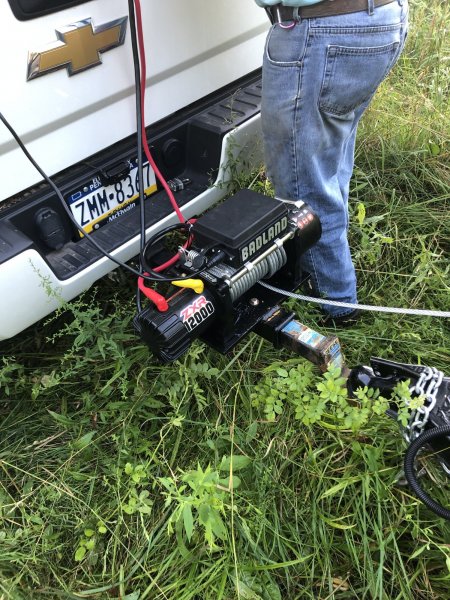

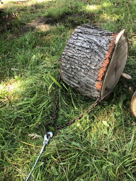

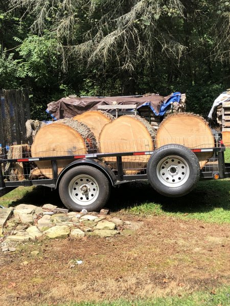

    Made a plate that fits into the receiver, then insert another hitch into that one to hold the trailer from tipping when loading heavy rounds, welded a fair lead on top rail of trailer to guide cable, use old school chained logging hooks. The rounds on the trailer are 41” dia, 24” long, 800 pounds.
    B0E3A789-80A8-44F2-998D-6C52CA30FCAE.jpeg 3EBC798A-F8C7-4904-AA81-3DADD51CE658.jpeg 8A418E97-C295-4990-B4BB-11FF0BBDDBBE.jpeg 360D431C-FE23-496C-83F0-748EF1F6BAD2.jpeg

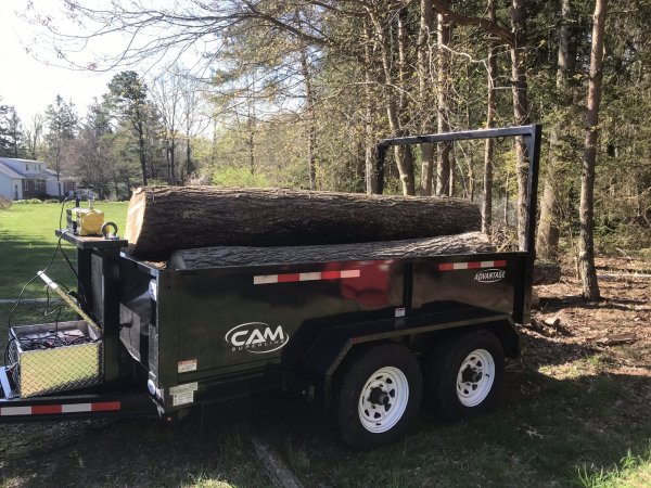

    Did this to my dump trailer. Pretty similar

    Like yours better but I already had a 5x10 trailer so I went this way. Many times I’ve thought about a dump.

    jo191145 , is that square "arch" at the back of the trailer a loading arch? Guy on youtube, Matthew Cremona, made a trailer with a log arch on it, dang impressive what he can load with it. Would love to be able to rig up something like that......
