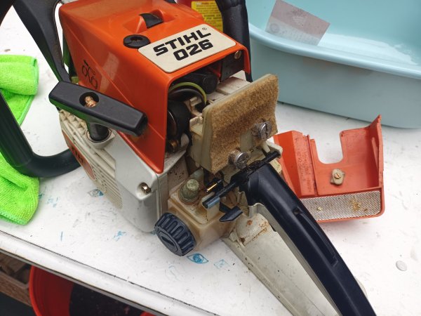

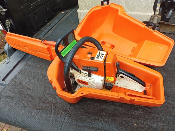

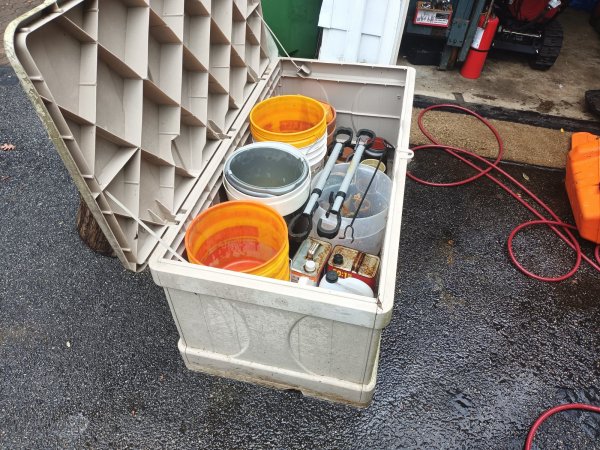

    I need another chainsaw like I need another kid......but I answered an ad today to pick up an outdoor storage bin........and as I was loading it into the truck the guy goes......"Hey do you want a garden cart?" I said let's go take a look. Tricam SD100-D. Looked in decent shape so I took it.
    As I was loading the cart into the bin that was already on the truck, he goes "Do you repair chainsaws??" and I was like "Why yes I do........" and it was because he saw the STIHL sticker on the back window of the cab.

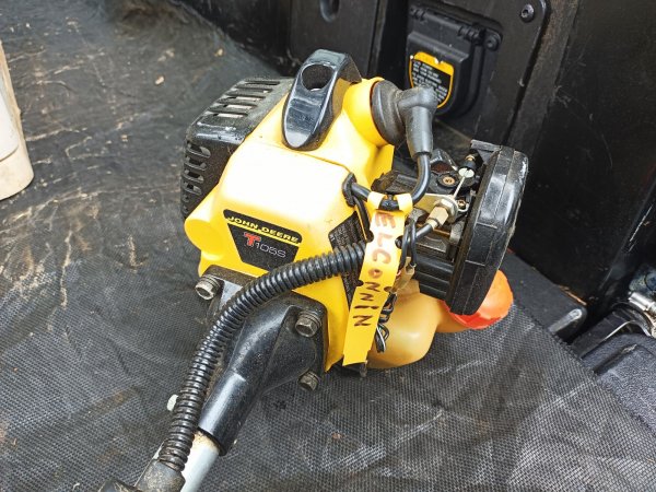

    He pulls out the hardcase and there's this almost new looking Stihl 026 and he's like "I got this chainsaw and I've replaced the carb 3 times and it doesn't run now but you can have it....." and I was like "Sure thing!" and while I was loading THAT he goes "Hey do you want a weedwacker? Same story, doesn't run...." and it was a John Deere T105S straight pole that he said could handle the hardcore brush cutters.
    Man what a score.....I went there for a cheap plastic bin worth maybe $40 new and came home with a garden cart, a chainsaw, a weedwacker.....oh and he also gave me a jug of bar and chain oil!!!
    Saw was made in 1998 +/- 1 year and has a brand new RS chain on there!
    2022-10-01 12.34.30.jpg 2022-10-01 12.34.38.jpg 2022-10-01 12.35.09.jpg 2022-10-01 12.35.16.jpg 2022-10-01 12.39.35.jpg 2022-10-01 12.39.43.jpg 2022-10-01 12.47.45.jpg 2022-10-01 12.52.49.jpg 2022-10-01 12.53.00.jpg 2022-10-01 13.18.45.jpg 2022-10-01 15.34.24.jpg 2022-10-01 15.35.04.jpg 2022-10-01 15.38.07.jpg 2022-10-01 15.38.13.jpg 2022-10-01 15.39.50.jpg 2022-10-01 16.00.17.jpg

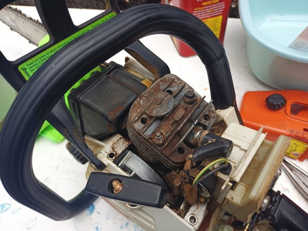

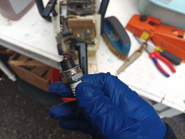

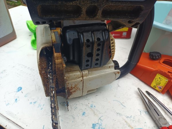

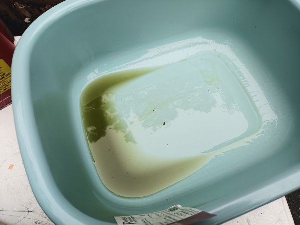

    Here's a video of it revving. First thing I did was dump the fuel and add some fresh TruFuel 50:1. Would not start. Then I pulled the plug (it was wet as you can see), cleaned it up, sprayed some starting fluid and it burped and then started and ran. Then I changed the fuel filter and it started up and ran which is what you see in the video. After that I put a capful of Lucas fuel injector cleaner and mixed it in a bottle with some TruFuel and now the saw won't idle right and revs high. Perhaps the Lucas cleaned out a clog. I did do the brake cleaner spray test around the PTO, the muffler, the base of the cylinder, and it passed that test. I'll have to adjust the saw tomorrow. Pretty stoked to get a free saw lmfao.

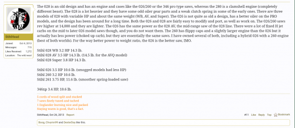

    I think you will like the 026 when you get it running, and will want to keep it.
    Here is some info from an old FHC topic:
    stihl recommendation

    Awesome! That was totally worth the time! We have a similar storage box. The pressure washer will clean up the haze on the textured parts no problem.
