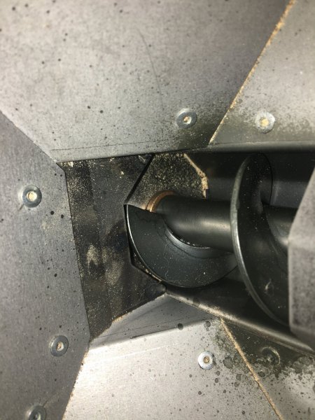

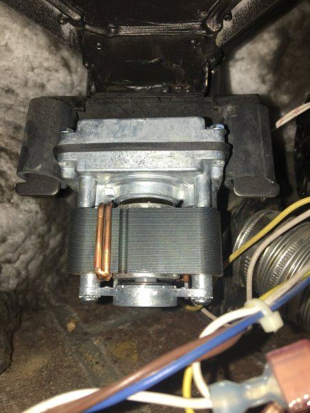

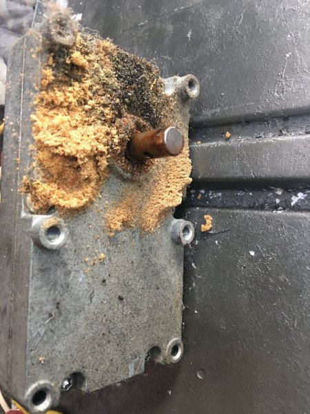

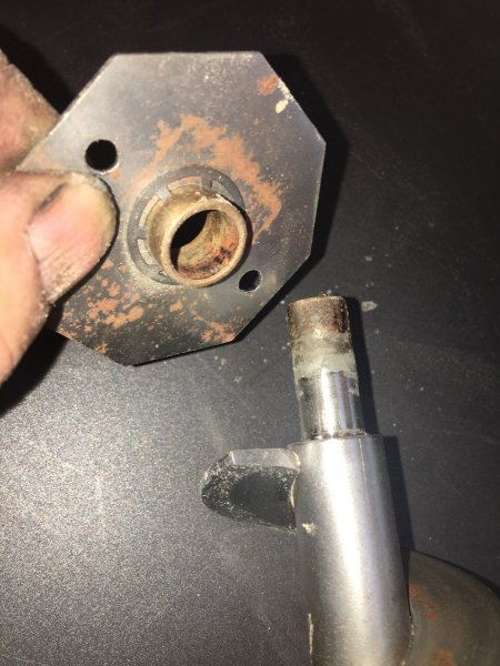

    This is out of a Breckwell
    We cleaned the auger with a wire wheel and replaced both top and bottom auger bearings. Added additional lube on the bearings using Anderal 465 synthetic bearing oil.
    Then installed a new heavy duty auger motor with sealed ball bearing. :)
    No More Auger Jammin Man!
