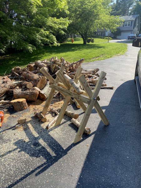

    CACFF6FF-7C7B-4B38-A425-AF4650957A10.jpeg I built this sawbuck yesterday following the directions from video made by Firewood For Life on YouTube. Only gave it a quick test. Works great and it holds me up completely. Couple changes I made to it was that I used shorter bolts to try to eliminate hitting the chain on a bolt. I also did not add another horizontal board to it, as was in the directions. It was heavy enough using PT wood. Maybe I’ll add that on after it dries out.

    Looks good Steve. Does it fold? Yeah those bolts can be deadly on chains.

    Folds, yes. I think I’ll leave loose like a sawhorse for easy unfolding.

    Wing nuts on loosening bolts?

    You might want to have a thin, sacrificial piece of wood laying in the crotch. It'll help keep the saw from nibbling away at structure.

    Good idea. I may do that
