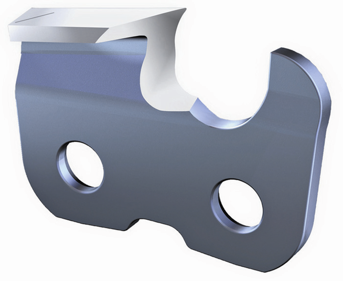

    1 . Stihl RS: full chisel, fast cutting in clean wood (no kickback , safety features , yellow link )
    RS3 is same cutter, but has a some kickback safety hump on the drive link.
    Harder to sharpen, angles are critical to keep it sharp & it's fast cutting performance.
    A favorite, little higher cost than the Oregon LGX / LPX
