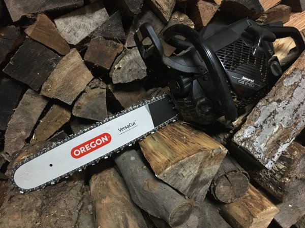

    I think Stihl Rollomatic ES is high quality. Had bad luck with an Oregon Versacut bar recently. Also, same with a small Husky bar.

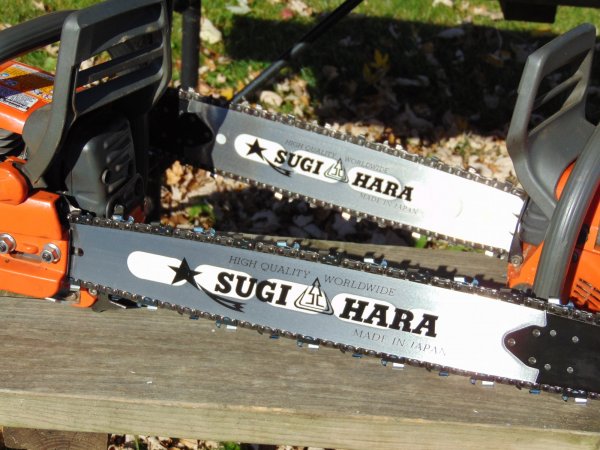

    I like the Sugihara a lot. Wear is excellent, the Japanese steel is very good! Yes, they're a bit more but worth it in the long run. Tsumura is very similar, I like them both.

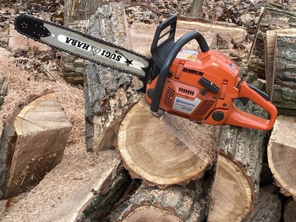

    I have sugihara on almost every one of my saws. Pricey, yes, but seem to be holding up well. Not enough experience with anything else to comment about. Except the factory bar that came on my Husqvarna 345, finally wore it out about 2 years before I joined up with you fine people

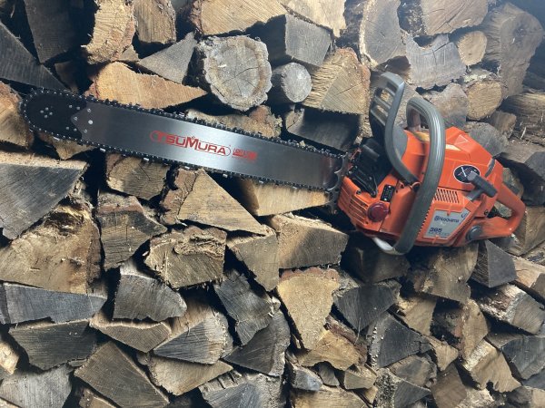

    I have over 20 mostly 24" tsumura many since the 80s they are still my favorite.

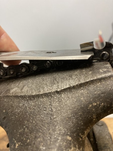

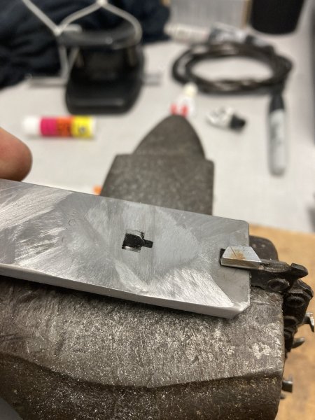

    How about raker maintenance? The progressive style guides/gauges keep each tooth taking the same amount no matter if one tooth is the whole way back to the witness mark and the next is brand new. Those kinds that ride on top don’t. You simply lay it on the chain like this and file even.
