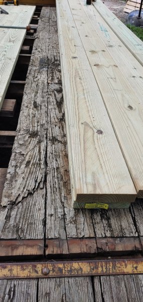

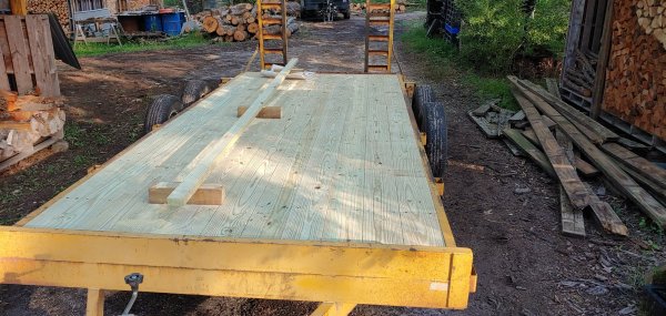

    Our flat bed trailer had treated lum6 on it, got it in 2007. Finally had to replace it in June '20. It hauled logs/scrap iron/equipment...don't remember ever putting anything on it 0611201519.jpg 0611201912.jpg
    If you really want it to last, get some white oak boards, sawn in the winter, put them on the trailer, wait until july/August when it's hot, and put several coats of diesel/used oil blend on it, a few days between coats. We did a trailer like that, floor lasted probably 25 yrs or more.
