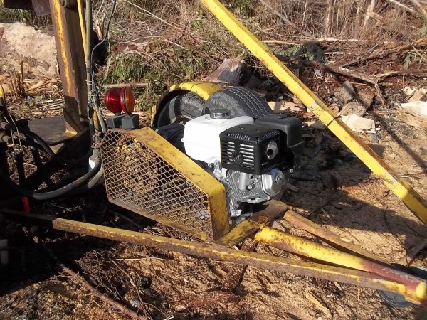

    I run at 1/2 to 3/4 throttle and burn about a quart per hour and the hydraulics run cool .
