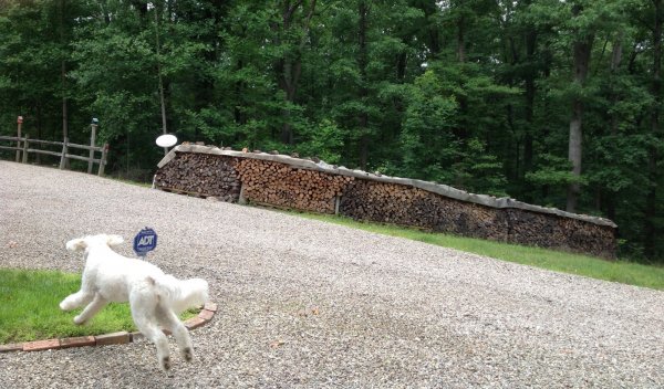

    I did mine at 33 - 35" for a single row and cut my wood around 18" - 20" or so. I found that the wind really catches the overhang, so I wouldn't go wider than I did. Might be best to try some cuts and put them on your stacks to see what you like. You will need a lot of weights on the top to keep them in place using single rows much more than I anticipated. The wider you cut it the more the wind can grab it.

    I had the same thing, big pieces from the roofer. I squared them up a little bit, measured and picked the width to get an even amount of pieces from the sheet without any waste. Mine vary in width from about 31" to 35". As heavy as this stuff is, I didn't expect it to be prone to blowing off when using it on single row stacks, but it is. Just need to keep loading the top with weight if it happens to you.
