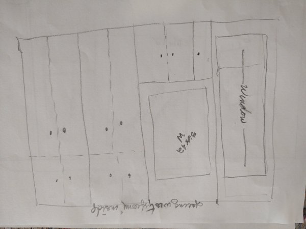

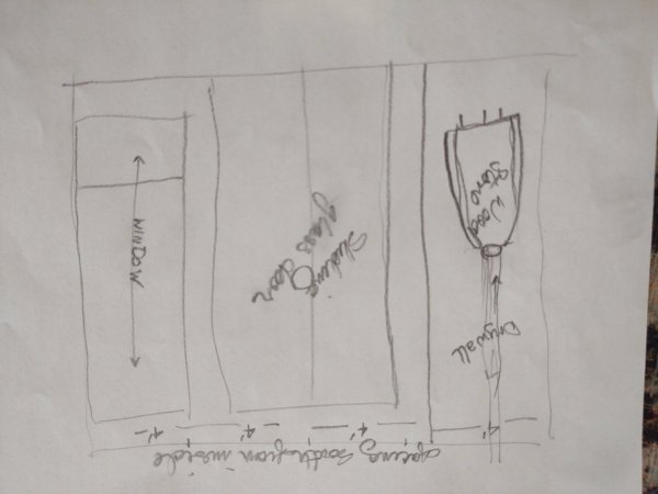

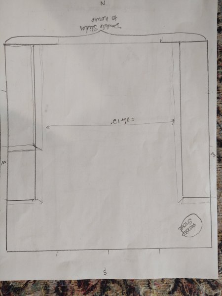

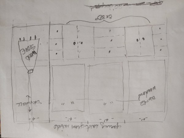

    How many indoor entrances to the room? And what does outdoor access/windows look like?
    Do you have any prelim sketches, H? Including part or most of the current footprint of your home...
    How will the new room be oriented? 20’ wall taking Eastern rising sun, 16’ facing south? Vice versa? Not aligned with the compass at all?
  3. wildwest
    29,548
    137,164
    Wyoming high plains
    I have some of each of our's chicken scratch, let me see if I can add from my cell phone :)
  4. wildwest
    29,548
    137,164
    Wyoming high plains
    Working on the correct orientation of the sketches...

  6. wildwest
    29,548
    137,164
    Wyoming high plains
  7. Eric VW
    24,174
    138,611
    Wow- your picture ideas are way more fancy than I would have suggested... but I’m more into rustic/reclaimed, less polished finishes. Absolutely not a fan of finished drywall.

    I don't know what I'm doing wrong, I rotated all the pictures on my computer and they appear right side up, but when I add them here they are not.
    We won't have those nice custom cabinets, gotta give the budget her attention...... But this is a step in what I'm looking at... He wants to do t&g rough cut wood for the ceiling and what little wall there is (I don't recall the species), bottom 1/2 of woodstove corner will likely be tile. Wasn't thinking about wall coverings when I wrote drywall...

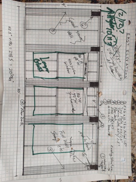

    Elevation from OUTSIDE

    Pencil from INSIDE

  15. Canadian border VT
    17,698
    115,243
    That will darken room quite a bit plan for more lighting
    where did pics go
  16. Eric VW
    24,174
    138,611
    A simple white wash/ pickling can do wonders (depending on species/grain), but generally, yes. :thumbs:
  17. Eric VW
    24,174
    138,611
    Oh, and ceiling fans to push the risen heat down... :whistle:

    Ha! Imagine the sink pedestals without sinks, just continuous counter. Laminate Formica counters.
    I get 1 or 2 4'x4' skylights, but darkening the room is the opposite I want for a SUNROOM.....
  19. Eric VW
    24,174
    138,611
    My dad and I did several sunrooms nearly the size of your project with pickled eastern red cedar tongue and groove, (2) 2’ x 4’ skylights... typically 2 sliding doors per wall x two walls... more than enough light.:yes:
